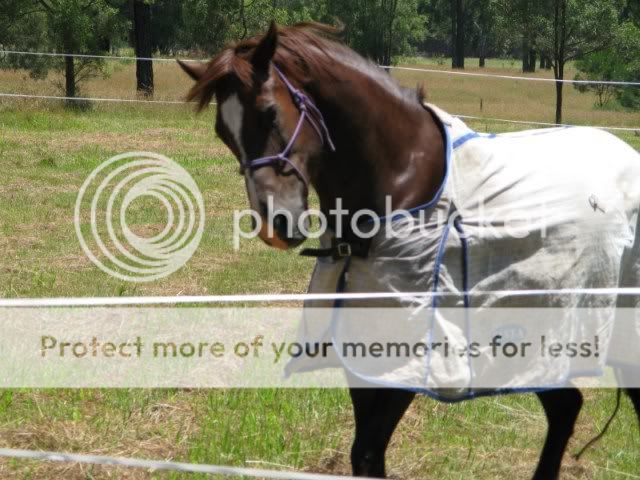

Hi y'all; I just joined and am new to boards and forums, etc. I have a problem I was hoping someone could help me with. There is an electric fence within 200 ft. of the room I jam in. It creates noise in my amp. Clean it is a steady tick like a metronome, but when I use high gain or distortion the tick becomes an ubearable whoomp. Is there an easy, 'cheap' fix for this that won't compromise my tone? I was thinking along the lines of a pre-plug that plugs into the outlet before I plug in the amp. It seems I have seen or heard of such a device in the past but can't remember what it is called or where to get one.

Thanks for all the input, guys. I really didn't expect any responses so quickly. It IS and old cattle fence. The house isn't on the same circuit, but it is so close it some times causes static on any and all other electronic devices in the house. Every recepticle in the room is filled with surge protectors. I did this to protect my toys and to up the availability of places to plug things in. I never seem to have enough outlets. Judging from what you have all told me, I suppose I should've ordered that copper tape I saw at Musician's Friend. At that time, I was thinking, 'My guitar doesn't hum', and it doesn't any place else but here. I suppose this solution is fine for my axes, but what about when friends come by to jam with me? I just can't see myself buying and installing the tape for each and every one of them. I'll try it though, then, if they begin to complain I'll have a sure fire remedy and can tell them about this site to learn how to install it themselves. Again, I really appreciate the quick responses from all of you. You all seem like a great bunch of brains with humor people. I'm glad I joined and will be back frequently.

We've been installing a few electric fences round here recently, and I have not picked any up on my amp although the nearest is a bit further away than yours. The general idea with these things is that a very high voltage pulse is applied between the wire and a ground stake, once every couple of seconds. The fence is completely isolated from ground, so normally, hardly any current should flow, unless something is in contact such as an animal, to complete the circuit. In our case, it is quoted as having a voltage output of 7,500V, making the electric fencing by far the largest, highest voltage device I have ever installed. But its very low current output, so not lethal. When a horse encounters such a fence, it causes a facial expression like this.....(my wifes horse demonstrates): As to your situation, my suspicion is that there is something seriously amiss with that fence. I think either it is leaking to ground, or, there is something wrong in its circuitry. As Sumgai points out, there are regulations about interference, and I cant see any reason why most of the possible RF interference cant be suppressed, and still maintain the short sharp pulses that are needed. cheers John
