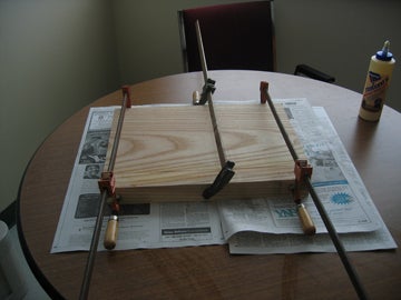

Post by cynical1 on Jun 7, 2011 6:25:33 GMT -5
Most of my clamp purchases go back over two decades. Unless I went out and looked at them I couldn't tell you who made them, but I believe they're mostly Jorgensen. I know they set me back a few. Odds are the folks who built most of mine are dead and gone from a fatal case of Offshoreitis. I have picked up a few pistol grip ratchet type bar clamps with the wider plastic covered jaws recently. I do like those as they're a lot easier to work with then the traditional threaded clamp jaws. The ones I picked up look like this: Depending on the reach they run around $25.00-$30.00...but don't quote me. The thing that sold me on these is the I-beam versus a flat bar in the design. You can toss a ridiculous amount of torque on these bad boys and they won't twist. The quick release feature is handy. If you've ever torqued the Hell out of a bar clamp and gone back the next day to get it off you'll understand. This quick release actually works. You can reverse the jaws and make a spreader out of them, but I haven't tired that yet. And my guess is he only used the vice grips to locate and hold the plexiglass sheet he used to protect the wood from the array of clamps. You're never going to get the distributed force needed to hold the cap to the body with vice grips. HTC1
Post by sbgodofmetal on Jun 7, 2011 8:44:24 GMT -5
Yeah l understand that completely, though l have only a few tools and no shop l do have several years experience working in them. l figured as much after l had time to think on it, at least l can get good c-clamps for around the same under $20 a set of 4, l love these warehouse/surplus sales.
Post by sbgodofmetal on Jun 7, 2011 9:55:43 GMT -5
l was just thinking, what if i drill holes along the sides of the boards and run dowel rods through them to aid in alinement. Wouldn't this also reduce the amount of clamping required???
Post by cynical1 on Jun 7, 2011 10:14:03 GMT -5
Generally speaking, about the only time you're going to use dowel pins for alignment is on a neck-through construction.
Either way, they won't reduce the amount of clamps you use. Your intention is to achieve the thinnest glue bond possible. That's where the strength comes from by evenly adhering the two surface together.
You could use the dowel pins and just stick the body between two sheets of plywood and park the truck on it overnight...that'll eliminate the need for all those clamps...
