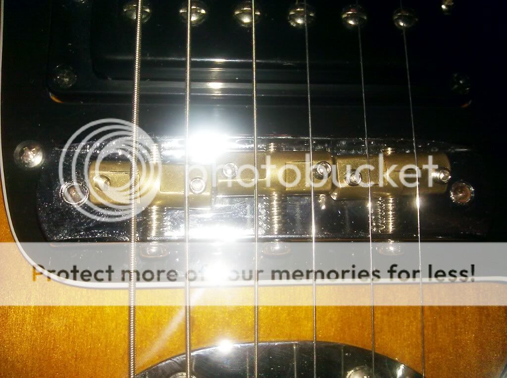

Post by thetragichero on Nov 11, 2011 13:38:12 GMT -5
finally did this to my jazzmaster! still needs a setup, but i prefer these to the six individual saddles
Post by sumgai on Nov 11, 2011 14:17:52 GMT -5
tth, Sorry, had to resize your second photo, it was way oversize. No harm done, now that ProBoards lets us use the width/height attributes within the IMG tags. And secondly, I'd like to use this photo as the answer to Karnak's Question - "How do you prevent a guitarist from properly intonating his strings?" IOW, they'll be close, but never close enough (at least not for me). As noted by Christo in the first post, some of the strings can be as far off as 10 cents (10 parts of a semi-tone). Most people, including the majority of your audience members, can detect mis-tuning as little as 5 cents off. That might explain why the dance floor is empty, and why the club manager is not asking you to come back and play there ever again. But hey, if it's got the right Mojo (Tone), then who am I to pee in your Cheerios?! ;D sumgai
Post by thetragichero on Nov 11, 2011 15:14:31 GMT -5
i'll take less than perfect intonation over the strings slipping out of the slots like they did with the old saddles, rendering them unplayable plus it's more than close enough for punk rock ;-)

Post by ChristoMephisto on Nov 21, 2011 11:37:21 GMT -5
finally did this to my jazzmaster! Not sure but I think your E/A and the D/G saddles are backwards The way mine are set up is how I see them on others, and have no problems with the intonation Cool to see this thread still going, thought it died off
Post by sumgai on Nov 21, 2011 12:59:40 GMT -5
CM,
To my eyes, those saddle pieces look to be 'reversible' - they can be oriented in either direction, because the 'offset' is more or less a mirror image. At least it looks that way in the photos...
In fact, all three of them look (again, to me) like they could be swapped around to any other position. Did the instructions say each one is designated to be used under some certain string pair?

Post by cynical1 on Nov 21, 2011 13:26:01 GMT -5
If I was to hazard a guess, I'd say the one on the left should be swapped with the middle one.

Post by thetragichero on Nov 21, 2011 16:19:32 GMT -5
no instructions, but looking at c1's suggestion, i bet that'll help me better intonate the low e (well, d on my guitars) string good catch!
