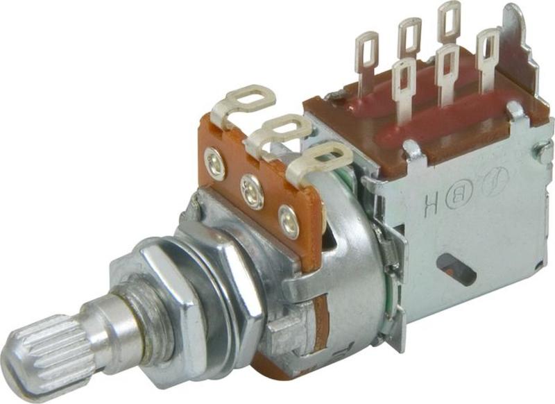

Hello, many of you might have witnessed a difficulty when trying to solder on the back of a push/pull pot (e.g. EP1201PP). Especially with the dimarzio i have read and tried successfully the following trick : just use what is found as "6.3mm female spade connectors" wind the bare/ground wires together, solder them a little , then tighten and clamp together the wires inside the connector's "tube", then just insert it to the special sleeve that this particular pot has : exact fit! : solderless, tireless wiring!
