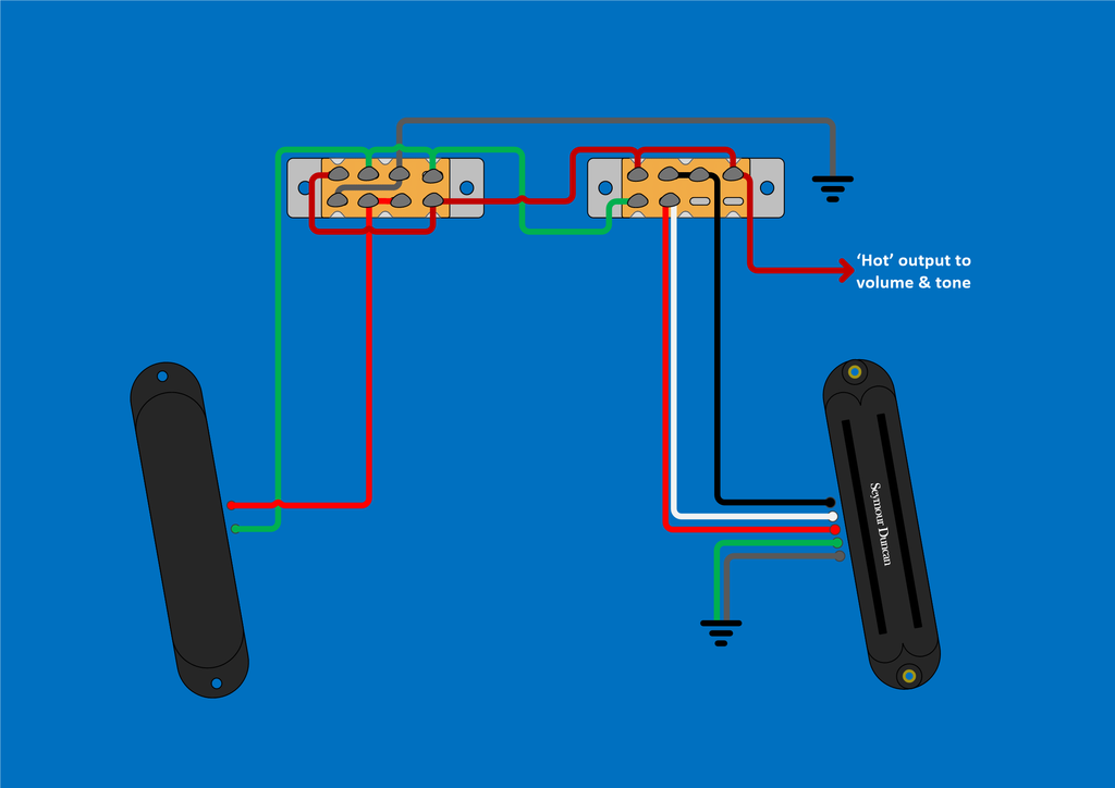

Post by Yogi B on Dec 13, 2016 21:01:52 GMT -5
Hmmm... ALSO one coil would Always be on! 🤔 I assume you're referring to: in the middle off position no contacts are connected so the link is left unconnected ( with the north coil hanging from hot) In the middle position both coils are off in the traditional sense, there is no complete path from hot to ground through either coil of the bridge humbucker, however the north coil is still connected to hot (but not ground) and as such may act as an antenna for noise -- thus is hanging from hot. You? Who? Well while merseymale was calling dibs, I was busy doing other things To that end I hope the following is devoid of error (for now I've taken the assumptions of a south neck coil with red:positive / green:negative, and standard Seymour Duncan colours for the bridge 'bucker):

Post by reTrEaD on Dec 13, 2016 22:20:26 GMT -5
You hold me in higher regard than I do myself! My reply was to something Yogi B said. My fault for the confusion. I just tossed a quote box around his words instead of clicking the quote box on his post. Yoohoo! To that end I hope the following is devoid of error (for now I've taken the assumptions of a south neck coil with red:positive / green:negative, and standard Seymour Duncan colours for the bridge 'bucker): You did a fine job. Your diagram will function as-advertised, given the assumptions. Of course merseymale will need to verify polarity of his existing neck pickup, the colors associated with it, and the brand of SC sized HB he'll be installing in the bridge, before everything can be translated to the final version he'll use. Worth noting: Fender assigns the slide switch positions toward the neck as "in-phase", although it really doesn't matter because of the redundancies. Both switches in the same direction gets you relative "in-phase" on a stock Mustang. However, since there is only one way we can choose in or out of phase (the Neck switch) in the new scheme, we should note that toward the tail on the Neck switch will have the Neck pickup in phase agreement with the Bridge pickup. Also, toward the tail on the Bridge switch is full HB. Toward the neck on the Bridge switch splits the HB to SC mode.
