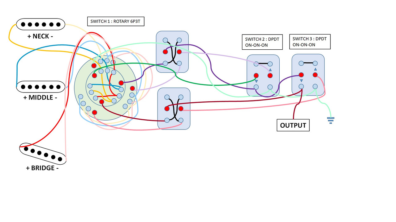

Post by alexis on Aug 27, 2020 15:09:39 GMT -5
This is a new version of this idea. We keep the 6P3T, but instead of using the 7P4T, we use two readily available DPDT On On On switches : And here is a video of me testing it : By the way, I discovered something interesting while building this mod : i frist settled on a rotary 6P3T, but I later found out that I could modify 2 existing, commercially available 3 way lever switches to work as one 6P3T switch (technical details : I used one double-wafered 4P3T and one single wafered 4P3T. Then I swapped one of the 2P3T wafer of the double-wafered switch with the 4P3T wafer of the single-wafered one). Alexis
