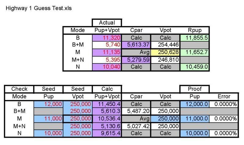

Here is a test based on a Fender Highway 1 Stratocaster and a check/proof thereof.

which is the actual value of the volume pot. Due to the limited resolution of even a 4 ½ digit multi-meter, this procedure should be performed on the Middle and Neck in parallel position as well and the volume pot results averaged.
Knowing this value, we can derive the actual resistance of each pickup.
1/(1/Bmeasured – 1/ResVpotAvg) = Bactual
1/(1/Mmeasured – 1/ResVpotAvg) = Mactual
1/(1/Nmeasured – 1/ResVpotAvg) = Nactual
