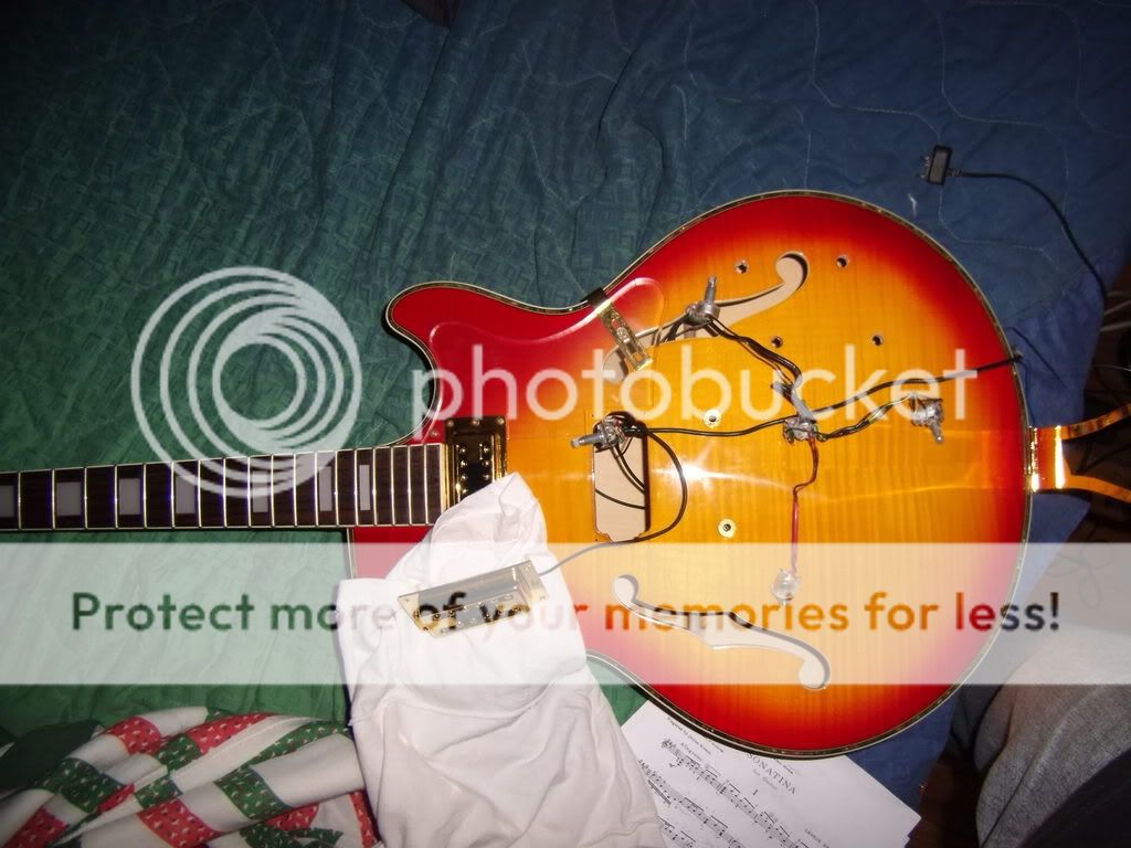

Post by duendeyerbero on Sept 18, 2008 23:04:31 GMT -5
Hey guys, as promised, here are a couple of pics.. jajaja, a BIG one! and here´s the one with the brand. It is a HOLMER! (altough HOMER would have been awesome!) Oh, and I didn´t went to the guitar tech to fix it because I wanted to learn how to do the job.....man and it is a LOT of work..... I got one more question..When I look at the diagram, the one from seymour duncan (2hb, 2 vol, 2 tones, 3 way switch) the pots from the left are actually the ones that go in the lower holes, cause they control the bridge right? Just a minor confussion...
Post by newey on Sept 19, 2008 5:25:51 GMT -5
DDB-
I don't see any pots in your photo, so I can't tell which ones are "to the left". Normally, in this type of 4-pot configuration, the two holes closest to the strings are for the Vol pots, with the bridge vol to the rear and the neck vol towards the neck, with the respective tone controls in the "lower" holes.
But since you have it apart, you can put them wherever it suits you- that's the beauty of customization. For example, if you use the tone controls a lot but keep the volume pots full-bore at all times, you might prefer the tone controls closer to your hand.
Of course, you are limited by the lengths of wire attached to the various pots, unless you are undoing all that as well.

DDB, Holmer, eh? Cool! now we can call you "homey", and you can call us all a yo' "peeps"! Thanks for not posting a GIANT pic, but I think we might actually need a URL (www address) that links to a GIANT pic because - as newey says, I don't see any pots in your photo. The problem is I am not clearly seeing much of anything in your first photo. I wonder if you can take a high res pic of the top (electronics) - like your first pic - and post the URL ADDRESS ONLY - i.e. don't use the {img} www,blahblablah,com {/img} command, just give us the address (e.g. i402.photobucket.com/albums/pp109/duendeyerbero/GEDC0011.jpg ) so that anyone interested can click on it and view the pic as up close as desired. Thanks, D2o

Post by ChrisK on Sept 19, 2008 21:53:42 GMT -5
I actually see four pots (but no dead people - "The Sixth Sense") in your picture. I don't know tho', DO they come from the bridge? I think that having the volume pots toward the neck end and the tone pots towards the other end, with the bridge/lead one of each toward the lower bout makes sense. Now, how are you going to get them back into their holes..... I know, you'll attach thin fishing line thru the appropriate hole to each pot/jack shaft/barrel.
