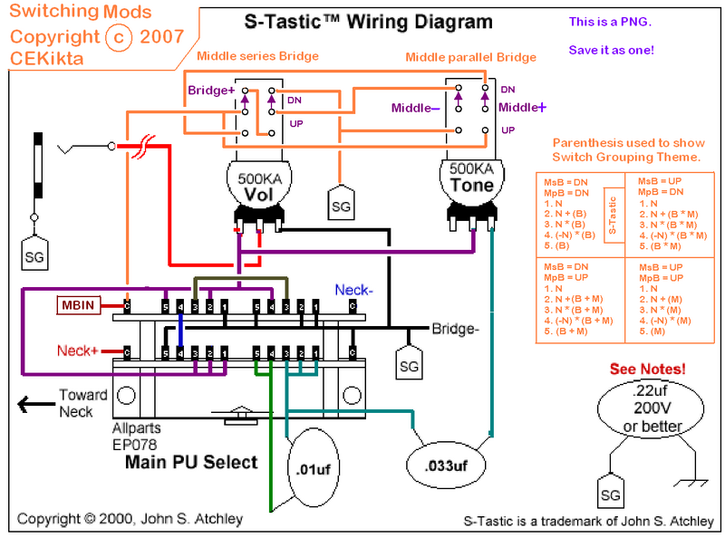

Post by ChrisK on Oct 24, 2007 18:10:10 GMT -5
VG3000 in the "Electronics and Wiring" thread wanted to use a push pull switch on the volume pot (in lieu of the S_Tastic middle volume pot) to add in the middle pickup (structure unspecified) and also wanted to use a second push pull switch on the tone pot to add a middle series OOP neck combo to an S-Tastic-based MIM Nash Tele. Well, OK folks.................... This one gives a good number of unique combinations (17) with no dead selections possible. A good mix of tones will result, especially on a MIM Nash Tele where the pickup types are dissimilar. While good for use on a three pickup master volume/master tone guitar, it can be used as well on a Strat (three pot) guitar with the third pot adding another tone (a la the original S-Tastic) and phase for a second pickup if a DPDT push pull is used. Teletype ;D ;D ;D (Oh wait, now I'll have to explain it to the snipperwappers.)
