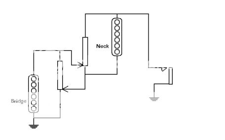

It's a unique (I believe) way to wire 2 pickups for an infinite fade between either pup and the pair in series and parallel.
Here's the basic wiring :
Looks totally bizarre - so consider the two pots at their extremes.
This combination gives both pups in parallel - with the two pots in parallel with the combination.
Here the pups are in series & each pot is in parallel with its own pup:

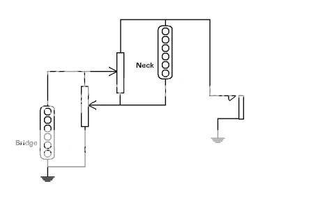

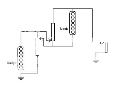

Here the bridge is "shorted out", leaving just the neck:
And likewise the bridge is left if the neck is "shorted":
