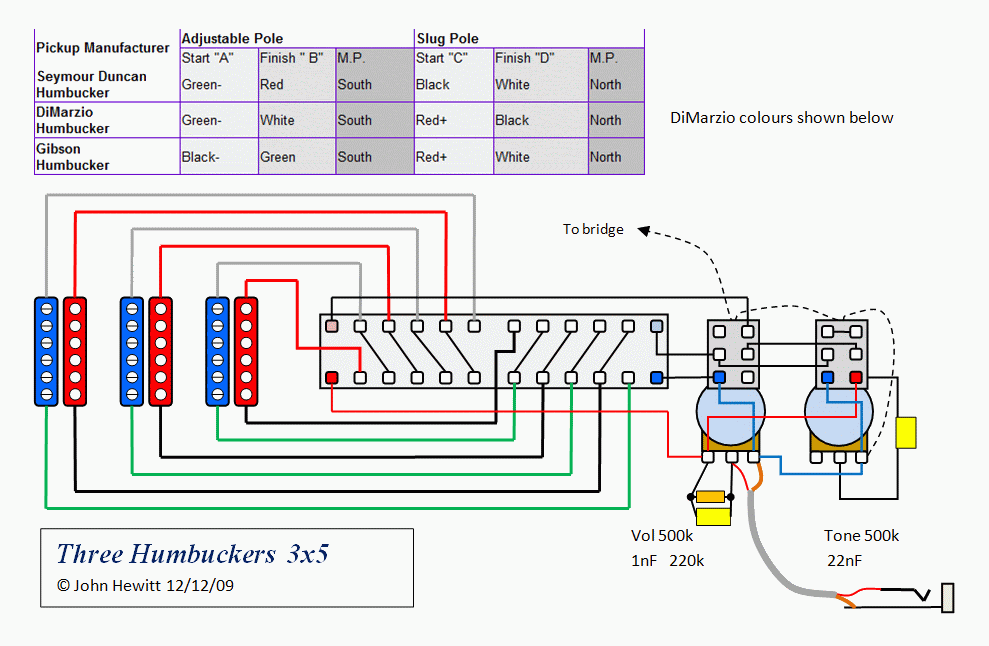

newey suggested using 2 Push/Pulls. I completely agree with this. But I want to know how it will work. What do It do when I pull up tone and when I pull up volume and when I pull up both. SO the idea could be clear in my mind. .. You said that one to switch between single coil or 2 coils mode and one for series or parallel when in 2 coils mode. So if I assigned the Volume to switch between Single coil or 2 coils mode and if I assigned the tone for series or parallel, thus, Volume Down : Humbucker Mode Volume Up : Singles Mode Tone Down : Series Connection Tone Up : Parallel Connection. What if I pulled both up. What will I get ? Singles in Parallel ? or nothing ? You just said "Series/Parallel when in 2 coils - Humbucker - mode" I'd like more clarification please. I liked your idea. I will like to have a clear idea about the 5 positions too.. because I become confused. I think that there will be some useless combinations for me. But if it is the only way using Push/Pull pots and 5 way superswitch, it is very welcomed. Thanks
Post by JohnH on Dec 10, 2009 20:22:44 GMT -5
Heres how the design coudl work:
You have three pickups, each with 2 coils, numbered 1, 2, 3, 4, 5, 6
The five way switch selects, coils 1-2, 2-3, 3-4, 4-5, 5-6, moving from bridge to neck. - in series if both push/pulls are in
Pull, say, the tone knob, and the cobinations change to 5 single coils: 1, 2, 3, 4, 5. In this case, pulling the volume knob as well does nothing
but if tone knob is in, pulling the volume knob changes the selected pairs from series to parallel

Thanks a lot of the clarification. That makes sense now. I'd like the volume to control humbucker/single mode, while tone controls series/parallel. Could be that a problem ? When Both are down, I will get position 2 and 4 are hum-cancelling for sure, right ? Well, I will say something for example. Tone is down (Humbucker/Single) and Volume is up (Series/Parallel). Now Singles are activated. Why pulling the the Volume won't turn them to parallel connection ? Or because we are using singles alone, they will be very weak ? I see that Humbucker Mode can go series or parallel, but singles mode can only go series, not parallel as I concluded. Why ? It is confusing a bit. It is the first time, I see these combinations. If I am working on my way, Volume (Hum/Single), Tone (Series/Parallel) Would it be like that ? V down /T down : Humbucker / Series V up /T down : Single / Series V down /T up : Humbucker / Parallel V up / T up : Single / Parallel ?? But it is very good way to achieve lots of combinations. I completely agree on your idea Many Many Thanks
Post by newey on Dec 10, 2009 20:50:58 GMT -5
YD- Parallel wiring of guitar pickups is the rule, series wiring is the exception- because it's more complicated, and simple equals cheap when one is in the business of mass producing things. Other than special models like Fender's Baja tele or the S-1 equipped Strats, Fender has always wired their pickups in parallel. On HB equipped guitars, the 2 coils of the HB are usually wired to together in series- but then the HB as a whole is wired in parallel to the other HB, in most 2-HB guitars like LPs and SGs. Series wiring is mostly left to Nutz like us! I have viewed your diagram, and there are several problems- in short, it won't do what you want it to. Let's mentally put that aside for the moment. Let's go back to the basics here. You said: Which combos are must-haves for you? Which ones would be useless, maybe they can be eliminated? I suggested 2 push/pulls because I was thinking that would be the minimum switching you would need to get close to what you want- I didn't really have a clear wiring scheme in mind. But JohnH apparently does- and it sounds like it has most of what you want. Just in general, I think you will find there are 2 basic approaches in using a superswitch to get the kinds of combos you want. Some diagrams use a p/p to split the superswitch in half, 2 poles on a side, so that pulling up the p/p switches from one set of 5 functions to another set of 5. This is often called a "mode switch" since it switches the superswitch between 2 separate modes. Of course, what you wire for each side can occupy no more than 2 poles. The other basic approach used is to reserve the superswitch for switching between various combos of the neck and bridge only, and switching the middle pickup in/out with the p/p pots. This is called the "middle on" scheme, and it has numerous variants putting the mid pup in series/parallel with the 5-way switch selection, or coil cut. However, adding several p/p pots can make things a bit "switchy" for stage use; many giggers prefer to have the 5 way give them some mid selections for ease of use. EDIT: Also, I think you may want to rethink the idea of splitting the middle pickup. The mid pickup is overwhelmed by the neck and bridge humbuckers, you stated. If so, one coil of the mid pup will be likewise overwhelmed by one coil of the neck or bridge, since the coils are so small in those SC-sized humbuckers. I would be tempted to mate the whole mid pup, in series or parallel HB mode, with one coil from either the neck or bridge HB- I think that's more likely to equalize things. If a "Middle On" scheme is used, a separate Vol control for that pickup is often used so the levels can be evened out.

Post by yamadron on Dec 11, 2009 9:36:34 GMT -5
This lesson was quite useful. I know most of what you've said, but some aspects were completely wrong. Well. It seems good to use both coils combined with one coil with the neck or bridge. But, as you know We want to make the 2 coils of the humbucker in the middle Hum-Cancelling in Pos3 and that is not hard. The question now is; you said: SO that means in the split positions, I will want to have both coils of the middle humbucker with the same polarity, so both can cancel hum with the reversed polarity of either bridge split coil or neck split coil. Is that right ? I made a small painting to illusrate what I mean.. Will this work ? Did that what you mean ? All positions are Hum Cancelling
1. Full Neck Humbucker 2. Neck South split coil + Full Middle Humbucker 3. Full Middle Humbucker 4. Bridge North split coil + Full Middle Humbucker 5. Full Bridge Humbucker I am agreeing in the idea. It seems good, so I think that we can proceed from this point.. Also something to consider, the neck pickup is just 300 mV and the SC-sized humbucker is 260mV, Won't spliting the neck coil while using both coils of the Middle Humbucker will make the middle humbucker more powerful than the Neck when splitted ? The Bridge is powerful enough to split with the middle ( 2 coils together), but the neck ? I'll leave anything about wiring now, till we manage how to get all positions hum-cancelling ? After, we figure out the best positions, I think we could go with wiring Thanks a lot guys. All 3 of you.. ;D
Post by JohnH on Dec 11, 2009 14:05:50 GMT -5
Y - unfortunately a pickup with two coils of the same polarity does not exist, there's always a north and a south. But this is not a problem, you just set all three pickups facing the same way, and now the coils are all alternately N. S, N, S, N, S, so any adjacent pair is hum canceling. In case we are talking about the same thing, this is the wiring I'm referring to in my contributions above: Its as hum canceling as possible. If you had three equal pups, it would be fully humcancelling in all the two-coil combinations (series or parallel). Since your pickups are different, it will be only partly humcancelling in positions 2 and 4, but I think that will be fine and its as good as you can do. After all, the single coil positions are not hum canceling at all, but yet they are still very usable on Strats as they would be here. If this is the way you want to go, we need to adjust this diagram to suit the wire colours from your Dimarzio pickups instead of Seymour Duncan, and also add the second switch. Is this the right idea? cheers John

Let me comment on John's diagram...... It does give you almost everything you wanted, except the Neck's two coils in parallel (ditto the Bridge), sumgai I reckon those sounds are in there too! - the only missing one out of the sweep of adjacent coils is one out of five of the single coil options. All adjacent pairs of two coils are provided for. J

Thanks newey, that makes me feel better Well, I think that I can have that orientation N S, N S, N S. Why there could be a problem ? I know what is the orientation of the Dimarzio pickups. Where is the north and where is the south. Why may they reverse it from a pickup to the other ? Aslo, I think they have provided a way to reverse the phase of the pickup. (is that have something to do with the polarity ?) Also balancing by raising the pickup to the strings or lowering them should not be a problem for me too. Unfortunately, my guitar has just 1 tone and 1 volume pots. yea, the middle one is weaker, but as SG said, It will be fine. Yes not perfect hum-cancelling, but is still better than having no hum-cancelling at all in these 2 positions. I hope John has an idea to let one coil from either neck or bridge humbuckers to be combined with the full Middle Humbucker, regardless of the perfect hum-cancelling at pos #2 & #4 Thanks
Post by JohnH on Dec 11, 2009 17:20:46 GMT -5
And here we say to make things balanced, we will need coils 2,3,4 in position 2 and 3,4,5 in pos4.
Did you include that in this diagram, or the diagram is build on your previous idea, before we say to have a split coil with the full middle humbucker ?
Well, as we will add a second P/P pot too. I'd like to have Volume P/P for (Single/Humb) and Tone P/P pot for (Series/Parallel).
Strat guitars are not hum-cancelling in Positions 1,3 and 5. You have included that already in the combinations, right ?
At positions 2 and 4 and as sumgai also told me, It is fine not to have a perfect hum-cancelling. Partial Hum-Cancelling is fine.
That is great. That is what I want. I am agreeing on your 2 push/pull idea with all their combinations. I want it now
BTW, what is the missing single coil option ?
That is all...
I'd go from this point.
Thanks..
THeres only two coils at a time in this scheme - not three. The diagram is currently drawn with a three position toggle, which I can change to two push/pulls. Of the six posible single coil sounds, it does all except one of the neck coils. That is not a problem, it will sound almost the same as the other neck coil. Honestly, this scheme should do what you want. However, just be aware that it is a new scheme, you will be the first to test it. Youll get plenty of support here if you do, but you are the one holding the soldering iron. So looking at the wiring diagram, do you feel that you can build it? If so, Ill revise it, adding a tone and volume control too. John

Post by JohnH on Dec 11, 2009 20:28:08 GMT -5
Yes
Almost, it would be like this:
1. V down /T down : Humbucker / Series - as normal for humbuckers = normal position. In positions 2 and 4 you get coils from two adjacent pups, in series.
2. V up /T down : Single - there's only one coil selected at a time on this setting, so theres no series - because series wiring needs at least two coils - you get 5 single coil sounds
3. V down /T up : Humbucker / Parallel In setting 3, it includes all parallel combos of adjacent coils, so positions 2 and 4 are a bit like those on a Strat, being a single from each of two pups
4. V up / T up : Single - its the same as setting number 2
So your default position is both knobs in with the normal humbucker coils-in-series settings, pull tone to change to humbucker parallel, or pull volume to change to single coil.
Dont worry - this is a cool scheme! Its gonna be great and I think you will like it
ps The fine black lines are wire links pps Where in the world are you?

You're probably right, there may not be a problem. But with different pickups, even from the same manufacturer, there are no guarantees the coils will be oriented the same on all three.
Reversing the phase of the pickup is the electrical equivalent of reversing the windings on the pickup. This makes the pickup "reverse wound" (designated "RW").
"Polarity" refers to the magnets in the pickups- meaning which end is the North pole of the magnet versus the South pole. Magnetic polarity can only be reversed by flipping the magnets 180°, and doing that usually involves some amount of dismembering of the pickup, not so easy to do. Reversing the polarity is designated "RP".
To be hum-cancelling, one coil must be both reverse wound as well as reverse polarity ("RWRP") with respect to the other coil with which it is being combined. Changing only one of the two variables, for example, reversing the wiring but not reversing the magnets, will not result in hum-cancellation.
Each HB has one coil RWRP with respect to the other coil of that HB. However, with different pickups, one's N coil may be next to the other's N coil. Meaning the adjacent 2 coils might not be humbucking.
You can check your particular pickups to see which coils are RWRP, thus ensuring you get the N,S,N,S, sequence you want. You only need to check the magnetic polarity, since by definition, the coils with reverse magnetic polarity will be reverse wound as well.
Do the test by holding one coil of one pickup up to one coil of the other. Remember the rule- opposites attract!
EDIT:Also remember that the side of the pickup with the wire coming out defines the side which will be closest to the controls. Keep this orientation in mind as you do the coil testing, so that you can mentally visualize how the pickups will actually be mounted in the guitar- so you know which coils you will be combining.
If you find that, instead of N,S,N,S,N,S, you get N,S,S,N,N,S, this means the mid pups's coils are opposite the other 2 pickups. You can solve this by rotating the mid pickup 180°, but this means the wires will now be coming out of the far side of the pickup, and may need to be extended to reach the control cavity.
Post by JohnH on Dec 11, 2009 22:24:25 GMT -5
Well this is what I think the diagram should be: I think its OK, but would anyone care to spot-check a combination or two? cheers John

neweyYou are always benefiting me with your knowledge. I am still new to this stuff, so I hope you can bear with me @johnThanks a lot for the diagram. I really liked the idea, otherwise I rejected the idea. The diagram is fully understandable too, but I have a problem now, Do I really need a 1 nF capacitor and 220K resistor for the volume pot ? If so where I may get them ? I already have the 22.3 nF Capacitor of the old Tone pot. I am also waiting for store to get another stock of Push/Pull pots, So I may not be able to test your wiring diagram now. As soon as I get the missing part, I will report my feedback directly Thanks a lot John. IOU1 xD
Post by JohnH on Dec 12, 2009 13:49:53 GMT -5
yamadron - don't worry about the 1nF and 220k resistor if you can't get them. They are not essential and you can omit them.
What they are is a treble bleed circuit. On many guitars, when you turn down the volume, the tone loses treble due to the way that the cord to the amp has a capacitance and acts like a treble reducing tine control, bleeding treble to ground. These extra parts compensate for this by sending a bit more treble through the circuit at lower volume, and I put them on all my designs.
Most commercial guitars do not have this treble-bleed circuit, and this design is not particularly needing them more than any other design. Also, they only act at reduced volume, so at full volume it makes no difference if they are there or not.
But if you do add them, they are very simple cheap parts that any electronics supplier will have.
Good luck with the wiring. In exchange for this design, when you are done, please post your feedback on how it went and what you think of the results and how it sounds - we are all learning too! Sound clips and photos are also much appreciated.
