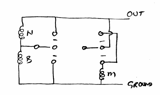

Post by JohnH on Apr 1, 2010 15:22:54 GMT -5
Certainly with a Superswitch there will be several ways to do this. But, just to be a smart-butt, here is a way with a standard 5 way: It has the Bridge and Neck wired in series, and one of them is shunted in positions 1, 2, 4 and 5, using half the switch, leaving both in series in position 3. The second half connects in the Middle in positions 2 and 4, not actually using the pole of the switch, but instaed using the fact that the centre lug gets bridged to an outer lug in 2 and 4. cheers John

Post by JohnH on Apr 1, 2010 16:40:05 GMT -5
Hey thanks! That looks great! Will it do exactly what I want it to? yes I think it will: N, N+M, NxB, B+M, B You'd have to add the pots of course, and since it is a schematic, relate the diagram to the layout of your switch. Thinking further on that: the volume is just a simple master volume after the switching. Put your two tone pots directly wired to the bridge and neck pickups (with their own tone caps). You'll get independent tone control in 1 and 2 with one tone pot and in 4 and 5 with the other. And in position 3, you have tone control of both pups independently. This gives you an extra special sound, with neck tone fully down and bridge fully up. This is a clear bright sound with bridge treble, but with neck power and weight. Hey, this is a good scheme - and deserves to be developed. Can you take it from there or do you want more diagram help? its better if you do it if you are able to. John

Post by sumgai on Apr 1, 2010 22:29:40 GMT -5
newey, minions said that he has already has a superswitch. John's scheme won't work with that because it depends (as per John's own description) on the "standard" Strat switch having the "built-in shorting" function. As with the better-quality Strat switches (Oak-Grigsby, et al), superswitches don't have that capability, they have a unique terminal (lug) for each switch position.... no shorting going on there. All of which means, a new (and cheap) switch is in minions' future, if he wants this simple but oh-so-elegant scheme. And a note to John..... Your diagram doesn't include switch position numbers. I foresee that someone will come along and wire it up, only to find that their switch "works backwards". Could I interest you in editing your diagram to include position numbers, please? Thanks. HTH sumgai
Post by JohnH on Apr 2, 2010 1:17:36 GMT -5
Although a standard Fender-style switch is the smplest way to do this scheme, it can be done with a superswitch, using two poles in parallel with lugs 1-2 and 3-4 bridged on one, and 2-3, 4-5 bridged on the other, to replicate the lug-bridging featuire of each pole of the the original switch. If this is wanted, I can sketch it out.

Post by sumgai on Apr 2, 2010 2:41:50 GMT -5
John, Yes, I also thought of "doubling up" on the superswitch poles, but that seems wasteful to me.... For the numbering, I left out (not on purpose, mind you ) that I would have simply gone with newey's contribution above, which stated "Position 1 is closest to the bridge". Even if the generally accepted usage changes (again!), at least for the purposes of this thread, the description and diagram would be consistent. sumgai

Post by JohnH on Apr 2, 2010 5:44:21 GMT -5
Ok, well, I think we have stumbled on another neat design here, so I am going to do a wiring diagram for it. Ill do it first with a standard Fender switch, since it leads to the opportunity for anyone with an unmodified Strat to make the mod with no extra parts needed, other than a second tone cap.
If required, you can use the greater functionality of a superswitch to replicate a standard switch however, which uses more poles but it would work fine and it cound save buying a new switch.
