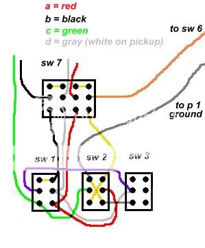

Hello GuitarNutz. I need some help with a crazy wiring idea that I have. This uses one humbucker. I used the DiMarzio pickup colors in the diagram. I know that there are some wires missing (on the phase switch for one, and ground wires) and some may not be right. I used a lot of different colors in the diagram so I could keep everything straight. I'm hoping some of you gurus can fix any errors and fill in the missing parts before I fire up the iron. Oh, and before anybody suggests it, yes I realize that I can use push/pull pots and/or concentric pots to save space, but I don't want to. This circuit will be going in a cheap guitar that will be used to demo the various sounds and I would like it wired with as many switches as I have in the diagram so there is no guessing as to what does what. I also know that some of these sounds may not be very useful with just one humbucker, but I want to hear them for myself. After I hear the sounds I like, I may put them in a different guitar with push/pulls or concentrics. A bit further explanation about some of the stuff in the diagram: sw1: series/parallel sw2: phase sw3: coil cut note: I would like this wired so that in coil cut mode, sw2 acts as a coil selector. I've seen it wired different ways so I'm not sure if my diagram is right sw4: varitone inductor tap, not sure if this can actually be done, what I would like to do is cut the inductor in half (like a coil cut on a humbucker), I'm pretty sure I saw a diagram somewhere where it was done like this. If it can't be done, then it can be changed so it can take the inductor in or out of the circuit sw5: killswitch, always in the circuit no matter what is taken out by other switches sw6: bypass pots, flipping this switch takes out p1, p2, p3, p4, and sw4. It has no effect on sw1, sw2, sw3, or sw5. This is like the "solo switch" on Wolf's site sw7: 4pdt, flipping this switch overrides sw1, sw2, & sw3 but has no effect on anything else. This will instantly give you the full power series out of phase sound. This was borrowed from a diagram on Mike Lindskold's (from Stew Mac) old site. He called it a "blower" switch note: when sw6 & sw7 are both activated, it eliminates every switch and pot from the circuit except for sw5, so you get humbucker--sw5--output jack only p1: volume p2: tone, wired to varitone and can alter the different settings like a normal tone control p3: midrange, based on the one that Torres Engineering sells. If the inductor on sw4 can be cut in half as described earlier, can the inductor on this pot also be cut and produce different sounds, or would the sounds not be all that different? I've never tried this midrange control but it sounds interesting. p4: varitone If anybody has any other suggestions to add to this crazy circuit, I am all ears, as long as it doesn't require adding batteries to the circuit. Also, do I need to ground the mini toggles, and if I do, how do I do it, solder a wire to the side of the switch? I've never used them before. Thank you!

I, too, haven't had time yet to trace through this. But we'll get it vetted before you fire up the iron.
I don't see how SW4 is doing anything. The center pole of the switch connects to one leg of the inductor, but the other leg is disconnected.
But you're definitely off to an ambitious start!
Post by ashcatlt on Oct 4, 2010 14:00:06 GMT -5
IF the inductor has three wires (including the center tap) AND you've illustrated one outside and the center wire AND the third wire goes somewhere meaningful (ground?) AND that's an SPDT toggle THEN that switch will work.
If you really want to do the phase flip, you can't have that green wire permanently grounded. Likewise, the red wire can't always go to hot. The phase switch decides which goes where.
Coil shunting only works in series mode. In parallel, it will cause silence. It's gonna be tough getting that switch to work in both modes.
Have you considered a 4-way switch to do Series/Parallel/One Coil/Other Coil? This could be either a rotary, or a Baja Tele style blade switch.

ashcatlt: the inductor has three wires or "prongs" (actually has three per side, one side is labeled "P" which is the side I think I need to use), and switch sw4 is spdt, so would I put one outer wire of the inductor to one outer lug on the switch, the center tap wire to the other outer lug on the switch, and the third (other outer) wire to ground?
About the phase flip, were you referring to the green wire going from sw1 to p1? Should I just eliminate this wire?
I don't want to use a 4-way switch, I'd like to get this to work with dpdts.
Post by ashcatlt on Oct 4, 2010 21:32:11 GMT -5
Your inductor is a transformer. P is for primary with the other side being the secondary. Use the side with the inductance you need. You understood what I was saying on the wiring of that switch. I'm not sure that you've got the inductor/tone pot/varitone wired correctly, but if you want to tap the inductor, this is one way to do it. Another (possibly better for noise reasons?) would be to put one outside wire on the middle of the switch with the blue wire from the pot, the center tap on one of the outside switch lugs, and the other outside wire from the inductor to ground. This will leave one of the switch lugs empty, and will short the "top" of the inductor, exactly the same way you're trying to do the coil cut.
I was referring to that green wire yes. This should go between p1 and one of the center lugs on sw2. While you're at it, you could remove the grey wire from sw3 to p1 and replace it with a jumper between sw3 and that same middle lug on sw2 where you're putting the green wire. This will let the phase switch choose the coil to which you're splitting, as requested, but still only in series mode.
The yellow wire from sw2 to sw7 is also a problem for the same reason the green wire needs to move. Move this to the other middle lug on sw2.
I can't see a way to make sw3 changes it's function in parallel mode without adding poles to at least one of the other switches.
sw5, 6, 7 all seem fine.
Post by ashcatlt on Oct 4, 2010 21:50:06 GMT -5
Ack, just noticed a couple other things.
1 - Moving the green wire, as I've suggested, makes sw2 actually work, but... When sw7 is flipped to "override mode", sw2 disconnects the HB's ground connection and will act as a noisy kill switch. I think sw7 will need another pole to avoid this action.
2 - Snip the purple wire between sw1 and sw3 and move the black wire between sw7 and sw1 to the place on sw1 where the purple was. Doesn't fix the parallel coil cut issue, but otherwise your "parallel" position will be silent because 3 of the 4 pickup wires go to the same place, and the 4th is not connected.
Post by ashcatlt on Oct 4, 2010 22:05:22 GMT -5
Okay, wait! I think I figured out how to fix the whole sw2 issue AND reduce sw7 to a DPDT.
Run the red wire from the pickup directly to where you've got it on sw1. Move the orange wire from sw7 to where I told you (a couple posts up) to put the yellow wire on sw2.
sw7 now overrides sw1 and sw3. sw2 will end up changing the absolute polarity of the whole humbucker, but both positions should sound exactly the same when in override mode. Really, it won't sound any different in any other mode either, except that it switches which coil gets cut in series mode.
That's a bunch of little things, ask for clarification if you need it.

Thanks for your help ashcatlt. I think I got it right according to your corrections: One thing I noticed though, now when you use sw7 to go into override mode, the red wire from the pickup is not connected. Will the pickup work?
Post by ashcatlt on Oct 4, 2010 23:12:06 GMT -5
Well, you'll need to connect the yellow wire to the orange, or you get nothing at all in override mode. Yes, as I said, we've just eliminated half of sw7.
Maybe we can use it in place of sw1 so that sw3 doesn't kill the thing in parallel mode?

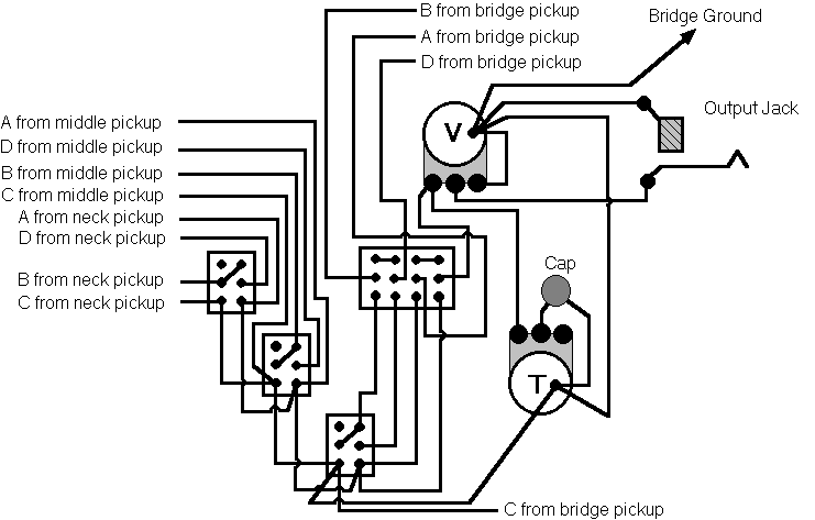

You and Space Ace have done considerable work in analyzing this circuit. Anyway, since you mentioned Series / Parallel / One Coil and other coil, there is another way to do this and here it is www.1728.com/guitar10.htmYes, I suppose this could also be done by using a Seymour Duncan Triple Shot ... if you are willing to part with $30.

Ok, I took another stab at it. Does this look like it will work? Again, in one position it doesn't affect sw1, sw2, or sw3. In the other position it goes to series out of phase, and the output goes to the bypass/solo switch.
Post by ashcatlt on Oct 6, 2010 8:46:50 GMT -5
You put that purple wire back. When sw1 is flipped toward the bottom lugs three of the four wires of the pickup go to the same place and the fourth goes nowhere. Ungood.
When sw2 is flipped toward the bottom lugs and sw7 is flipped toward the top, the green wire goes nowhere. Ungood again.
You were very close the last time, except for the change I mentioned where you connect the yellow and orange wires and have the option of using a DPDT for sw7.

The first thing is that the solution I’ve put forward is set up in such a way that sw7 will not override sw2. I think we can fix that with a little jostling of sw7, but I also don’t think it’s a big deal. This sw2 is only really selecting which coil gets cut when sw3 is flipped, and even then only when sw1 is in series mode. Which brings us to the bigger issue.
I can not find a way to get sw3 to stop acting as a kill switch in parallel mode! Even if we accept that sw2 will always be in circuit, and move the 4P switch, I still don’t think we can make it work. Maybe if we had extra poles on both sw1 and sw3, but that’s getting to be a bit much. You haven’t expressed any concern re: this situation, but it bugs the heck out of me. It’s exactly the kind of “surprise” dead spot that we try to avoid around here. I know this is meant just for experimentation, but might it not be nice if it was as functional as possible in case you do want to use it in a live situation, or even transplant the circuit to something more permanent?
I did suggest that 4-way switch which you didn’t like. I can understand that. They can be kind of fiddly, and it’s hard to decide on a truly intuitive switching order. I think maybe we should take another look at what wolf posted. Here’s the link, so you don’t have to scroll for it.
What he’s got there is a 3-way switch – it could be a Tele switch, a Gibson toggle, but I figure you’d prefer a DPDT (on-on-on) – which selects One Coil/Parallel/Other Coil. Then there’s a DPDT (on-on) wired to act as a “series override” – no matter what the 3-way is doing, it’s forced to both coils in series. We could easily tack a phase switch onto this.
We could also use the 4P to override all three of these switches if you really want, but I don’t think it would be necessary, since it would be mostly redundant with the (on-on) switch which already does most of the override thing you want. Yes the phase switch would still be active in any position of the other switches, but as I said above I don’t think that’s a big deal.
You’re aware, of course, that aside from selecting which coil gets cut in your current iteration the phase switch will make no noticeable difference in the sound of this circuit? The only time it will ever make any change is when you’re playing through some relatively high gain, sustaining a note, and getting some reinforcement (resonant string feedback) from the amplifier. In this case, flipping the phase switch while holding the note might cause the amplifier to suppress the fundamental of the note, causing it to break off into feedback on some harmonic of the original note. This could be cool, but I think has fairly limited application, and certainly doesn’t warrant going to all this trouble to bypass it.

Edit - We'll need to change wolf's diagram (we're talking about the bottom one on that page) just a little to accomodate a DPDT (on-on-on) rather than the Gibson toggle he's illustrated. It's a simple thing, though.

just a thought on sw3, related to stopping it acting as a kill switch in parallel mode.
Based on the diagram in reply 9, if the white wire from sw3 was moved to connect to the yellow link wire across the top lugs of sw1, then the coil cut would only happen in series mode, and sw3 would do nothing in parallel mode.
If wanted, the other side of sw3 could then be used to cut the connections for the disused coil, so then it could be coil cut in both series and parallel.
Post by ashcatlt on Oct 6, 2010 19:03:59 GMT -5
JohnH, that's a good catch! It would mean we'd have to choose a coil to split to in parallel. We wouldn't be able to choose the single coil with the phase switch. Also, would it not leave the disconnected coil hanging from hot when the phase was flipped?

Okay, I believe a good way to solve the series/parallel coil-cut switching is with (yes my idea) I think a phase switch could be put in there, and I'll draw it if somone wants to see it.

Okay, I decided to draw a little more: Among other things, this will eliminate the need for a coil cut switch because this yields all four possible combinations: series/parallel/ and either coil. I know the phase switch puts it out of phase with itself (a rather lousy sound I think) but since you wanted a phase switch I didn't know how else to wire it. The volume and tone controls could be easily bypassed by what I call a "solo switch". The inductor switch is an interesting idea. If you can't find a center tapped inductor, then you could try wiring 2 separate inductors as if they are a humbucking pickup. For example, if you have 2 one Henry humbuckers, you could get values of .5, 1 and 2 Henries. Well those are my ideas for the moment.
Post by wolf on Oct 9, 2010 2:35:11 GMT -5
Well, I figured I'd take that one step further farther more distanter and came up with this: I know I have made several changes but I hope they were all for the better. I also know there could be several problems such as two tone controls that are always active. Anyway, I figured I'd toss this out and see what you'd think. By the way, is Space Ace still locked out of this thread? (I mean he hasn't made a post since when? ... the Renaissance?)
