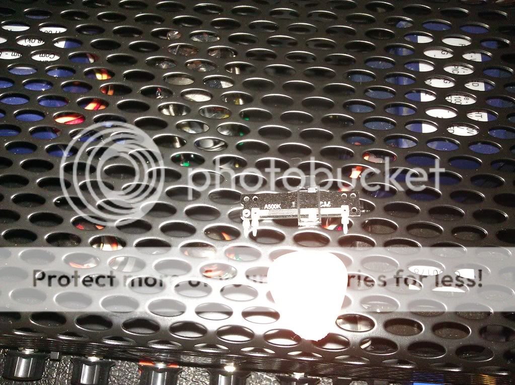

i added two 500k (one audio, one linear) slider pots to a recent mouser order because they were cheap and i thought could be fun to play with they're small enough to fit under a humbucker ring with a bit of shaving of the ring (i think)
if you could add another pot to a strat, what would it be? separate tone pot for each pickup?

Post by thetragichero on Dec 21, 2010 23:59:17 GMT -5
652-PDV20-31P-504A 652-PDV20-21P-504B these things are TINY that bright flash under it is a pick for size comparison it also has a center detent
Post by JFrankParnell on Dec 22, 2010 12:13:04 GMT -5
wow, tiny. and i think those would be less prone to puddling than mine in case of beer catastrophe
Post by thetragichero on Dec 22, 2010 13:28:32 GMT -5
yeah and they're like 80 cents i think i'll screw it to the humbucker ring on my strat and make it a third tone control next time i change strings/pickups

How many terminals are on those? I think it would be cool to have a slider where you could pick which coils of the HB you want on. Center is both, neck coil only is towards neck, bridge coil only towards bridge, blend inbetween..... Back from fanstasy world, the third tone sounds good. Either that or master volume, then switch your normal "volume" into a "tone" reason i'm thinking i'll make it a tone as opposed to volume pot is that i don't really mess with the tone knobs while playing, but do with the volume knob also these pots seem a bit fragile, so i'd rather not have it subjected to the abuse the volume pot receives the nut in me thinks i should add one slider pot to each side of the humbucker ring ;D
