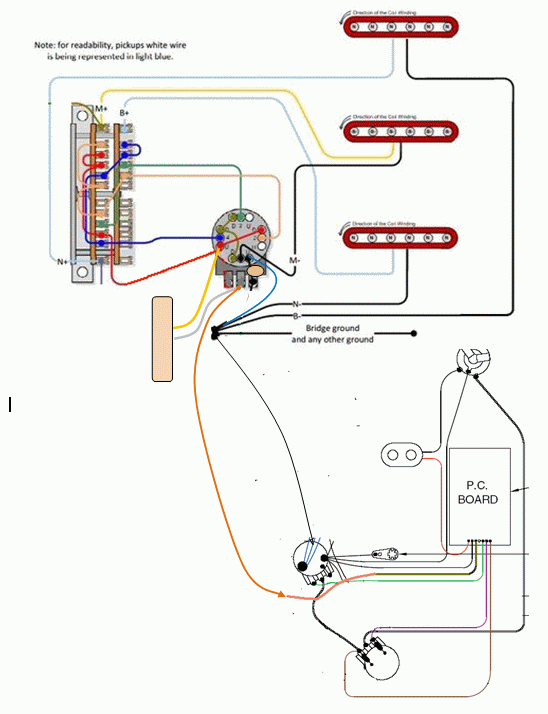

Ok , heres where I am after 3 day of beating my head into a wall. I thought it would be a straight forward job to merge two wiring schemes that I like together. Maybe not so much. Could some kind soul help me un-F@#* this. Heres the one I am trying to make out of the other two. Starting with this. Trying to add this to the powerhouse wiring.
Post by lookbunnyrabbit on Nov 6, 2015 17:13:17 GMT -5
Cleaned up the drawing some so its a bit easier on the eyes. one of the many areas Im not sure of is where the tone cap is placed.
Post by newey on Nov 7, 2015 9:04:43 GMT -5
lbr-
Sorry that no one got back to you on this, but I confess to not being able to read the wiring in/around that Superswitch. It's a pretty diagram but not very easy on the eyes, even in the revised version.
But also, the two schemes you are trying to merge both show 3 single coil pickups, but your new diagram shows a 4th one? Where did that come from?

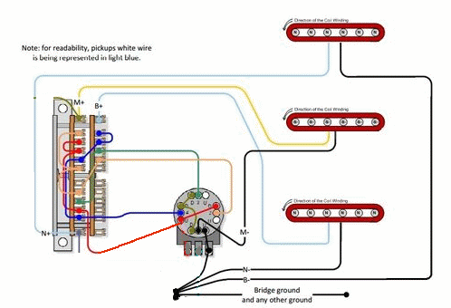

Post by lookbunnyrabbit on Nov 7, 2015 9:17:45 GMT -5
Im sorry about that, I tried to do my best to make it readable. Ive never had to deal with so many wires before on a drawing.
The 4th pickup is a dummy coil. It is also in the powerhouse diagram along side of the pots. All 3 pickups are the same(north) the fourth is south. Wires in blue are white the pots are: Vol 50k AT Tone 250k AT (replaced with S1 250k AT) Boost 25k AT tone cap .022uf resister 1: 24k resister 2: 47k

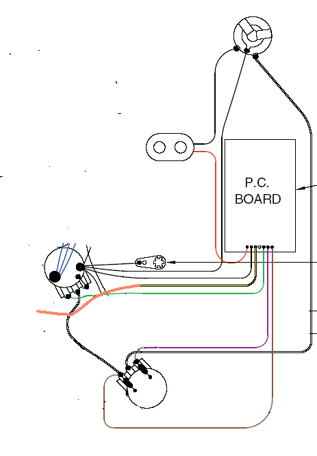

As for the tone control, the Powerhouse scheme doesn't show any tone capacitors which I take to mean that the tone control is an active one, and the capacitance is supplied at the Powerhouse board. Is there any description of what the knobs are doing in that scheme?
EDIT: OK, I got confused, I see the tone cap now on the first diagram. Part of the problem is trying to flip back and forth between three diagrams.
A couple of general points: First, if we are going to try to be able to vet your diagram, it needs to be expanded so the connections can be traced. This is really the kind of thing where we should be starting with a schematic rather than a wiring diagram. Second, the powerhouse module is treated in a "black box" fashion, IOW, we don't know what's going on inside. That's probably fine if the whole thing is switched in/out at some point, but if not we may not be able to tell if it's playing well with the S1 wiring.
Finally, at the very least, we will need a "truth table" setting out what you expect to happen for each position of the S1 and the superswitch. I got what happens with the Am Dlx scheme, but where does the Powerhouse module come into play?

Well that is where I get in over my head. Here is the truth table from my other strat which is wired with that S1 wiring diagram.
S1 in Up position (Stnd Stratocaster) Pos 1.---------------Neck Pos 2. --------------Neck in parallel with Middle Pos 3.---------------Middle Pos 4. --------------Middle in Parallel with Bridge Pos 5. --------------Bridge S1 in Down positon Pos 1.---------------Neck in series with Middle Pos 2.---------------Neck in Parallel with Bridge Pos 3.---------------Both virtual humbuckers in parallel Pos 4.---------------virtual bridge HB in parallel with neck Pos 5.---------------Bridge in series with Middle
I realized that because I dont have a reverse wound middle that the down position isnt going to be the same. I was just hoping to get it in the ball park. Being lickdysic and having the attention span of a ferret, working out wiring is something of a week long affair. It would be nice if I could replicate those positions as I use all off them. I originally wanted to do exactly the same scheme but I also love the mid boost that the powerhouse provides as well as the hum cancelling. Somewhere in my feeble mind, I thought I would like the best of both. (not knowing even if it is possible.)

Without tracing all the wires out (since I can't make out all the connections), just in general, I looked at the S-1 switch as wired in the original AmDlx scheme. It's used up, there's no portion of the S-1 that isn't already used. That means that the Powerhouse circuit can't be switched by the S-1.
Now, maybe you could use the 5-way to switch it in/out along with the mid pickup, but again, I can't tell because the Superswitch isn't decipherable as currently drawn. And, you may not want the Powerhouse always in the circuit anyway, you may want to have the mid pup in the Std Strat scheme to be unboosted.
Based just on the above, it seems to me that the best way to combine the two schemes is to add a switch that would switch the Powerhouse circuit in/out independently. A DPDT switch (which could be a P/P on one of the other pots) would allow you to switch the "hot" lead of the powerhouse, and the other pole would be used to disconnect the battery so that it isn't "on" anytime you've got a cable plugged in (This may cause a bit of a "pop" when the switch is thrown, but there are fixes for that).

When talking of a virtual humbucker, what is that? Is it two pickups like N and M in series, forming a humcancelling combo? or is it a pickup in series with the dummy coil to get hum cancelling?
The Fender Am deluxe designs using S1 and Superswitch, of which there are about 3 since 2004, all tend to max-out those switches, so there's no poles left to do even more stuff. But we have plenty of designs where we get many versions of series/parallel, using just a 2 pole switch instead of a 4 pole S1 switch. If you reconfigured with one of those, then the rest of the S1 could be used to strategically connect a dummy coil just in settings where it would help such as NB combos. (dummy coil to be added in series, on the ground side probably). See the schematics section, my offerings would be based on Strat SP or SN designs.
I think with that active module, its better to embrace it fully, with its special pots, and just accept that you will have a powerful active output. There may well be an extra benefit too. When people get doubtful about the tone loss due to adding dummy coils, the main culprit is the extra impedance that it adds, combined with cable capacitance to the amp dulling the tone, which is natural but is greater when more coils are in series. The active stage will protect from most of that, so the tone loss of adding the dummy coil may be less than usual.

To accomplish the request in the OP, we start with the S1 scheme in whole.
Replace the red wire from the 5way to the V pot with the dummy coil.
Move that purplish wire that goes from the switch to the T pot so that it connects to where that red wire went on the V instead of the switch.
Yank out the other T pot and toss it aside. Jam the boost pot in that hole and wire it to the PH module and the jack tip exactly as shown.
The "hot" wire (in blue going from V to jack on the S1) now goes to yellow on PH.
Green wire from the PH goes to the same place as brown. The fact that brown is labeled "...ground" raises a flag, but this is what happens when the V pot in the PH scheme is turned all the way up, and we're wiring it to be "all the way up" permanently, so...
I think we're done now. S1 switching, dummy coil "virtual humbucker", Master V and T, active boost, RLC "mid boost" tone control. Wanna try to draw that?

All good questions. Replace the red wire from the 5way to the V pot with the dummy coil. That I think I get. using the dummy coil as that red wire?Yes. You can use wires to connect it if it's leads don't reach. Edit - Except WAIT!!! We're talking about the red wire on the S1 diagram! Do not put the dummy coil in place of the wire to the battery clip! I started with the S1 picture. That, I think, is the basic issue with many of these questions. At this point we shouldn't even be looking at the PH wiring at all. I suppose I should have gone the other way, since that's what's in the guitar, but for putting together a drawing it shouldn't matter either way. My instructions are on how to draw it, not how to build it. There's a purple line from the 5 way to the top T pot. We want that pot connected the V pot where the dummy coil is now going as you surmised. Yep, that's part of the confusion... The thing about tossing and jamming was kind of metaphorical. We're still talking about drawing, not building. See, cause I again was looking at the S1 picture, where there is quite clearly a light blue wire going from the wiper of the V to the jack tip. That needs to go to the audio input in the PH. This now is the first time we're actually looking at the PH diagram at all, and looking at that diagram that you posted originally it just plain can't work if yellow is audio out. The only connection from the pickups to the module is via that yellow wire. So, either the diagram or the list you posted is wrong. And that I think answers the next question, too. Again, the diagram can't work that way. You should figure out which is correct, and then translate my instructions to fit. In fact, it won't hurt anything just to find out the "hard way". Just wire it up one way, if it doesn't work, swap the yellow and green from the PH and go on with life. Don't confuse the Volume pot with the weird mid boost thing. We're taking the V pot out of its position between the preamp and the mid boost whatever, so we replace it with straight wire to the mid boost whatever.

The Powerhouse drawing, with the active module and dummy coil. Is that what you actually have now on the guitar?

The powerhouse is what I have wired to the guitar.

The Powerhouse design seems to always feed the signal consistently through the dummy coil to get to the module. That suggests that the pickups are all the same polarity ie no rwrp M pickup. That is the simplest way of using a dummy coil. You could check that with a compass or another small magnet. All pickups would attract/ repel the same.
They are. it uses 3 am strat pickups (north) and one tele pickup with only the two most outer pole pieces. (RWRP)
If that's the case, where does it leaveyour new project? Are you going to build this into the powerhouse Strat with its current pickups? Or if it is a new build, is it with an RWRP M pickup as normal?
The current pickups. They sound good in the Powerhouse circuit. All the stock positions go from being bone stock sounding to almost a humbucker thickness. I also really enjoy the S1 downs that DAllen hooked me up with. I was trying to make a Reeses.
If this scheme is going into the Powerhouse Strat then I think the intent is ok and it will be along the lines of what ashcatlt is describing. We could work with that. The dummy will be expected to work well in single and parallel settings and partially in series settings. (IE similar hum to one single, but louder output so better signal to hum ratio in serie mode)
If it if with a normal RWRP strat set though, then id suggest lose the dummy coil and we can splice the module onto Dave A's diagram.

JohnH, that'll give you redundant Volumes and no "normal" Tone. I wasn't done explaining yet! On the Dave Allen diagram, I moved the connection from superswitch to pot and freed up that pot, so it is ready to be converted to become the new passive tone pot, adding a tone cap. The dummy coil should be added between the red wire (which I moved) and the tone pot. Output from the dummy coil/tone pot goes to the power module (yellow wire, which I extended in orange) Ground everything that needs grounding. Bunnyrabbit, maybe you can go from there? Or, I can splice them together at the weekend. My thought is, work with these part diagrams first, even though they may not be beautiful as a result (like Frankensteins monster), because we know that they both come from designs that work. Tben, when its all hooked up, use the result as a reference to redraw it if you want to.
