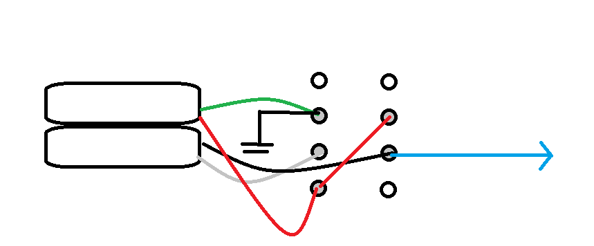

I was wondering whether someone could help me out. I'm new to both three-way switches and humbucker coil-splitting and I'm having some trouble working out how to set up a new Mustang I'm building. I'm aiming for split-off-humbucker and I've come up with the following. Would anyone be able to take a look and see whether I'm even close?

There really is no need to connect the green wire to the switch at all, it can just be grounded, since it isn't being switched by the slide switch anyway. The black jumper wire could be eliminated on that side of the switch if you just grounded the second-from-the-top lug so as to ground out the white/red pair for the coil split. This would eliminate a couple of solder connections, and the fewer connections needed, the better from a reliability standpoint.

Post by t89rex on Mar 16, 2021 0:56:51 GMT -5
Thanks for the quick response newey. Really appreciate it.
Unfortunately I'm a total dope and forgot what I was doing. I'm using wide-range style humbuckers and was told not to try to split them as the poles under the cover would be quieter than the exposed ones. What I'm actually trying to do is get parallel-off-series for each pickup. Back to the drawing board...
I'm wondering whether this is it:
Post by newey on Mar 16, 2021 5:48:30 GMT -5
That's it. Although I don't know why someone would say you shouldn't split the HBs.
Post by reTrEaD on Mar 16, 2021 9:44:46 GMT -5
I'm wondering whether this is it: I don't think you want that. If you look at what happens on the right side of the switches in the center position, the hot is connected directly to ground. Good if you only have one pickup because the off position will be silent.. But very bad if you have two and want to select just one. The one that is switched off will kill the sound from the one that's in Series or Parallel mode. Unfortunately I'm a total dope and forgot what I was doing. I'm using wide-range style humbuckers and was told not to try to split them as the poles under the cover would be quieter than the exposed ones. You mean like these? Intuitively, I would think three of the strings would be louder on a split using those pickups. But I'm not sure if that's true or how much difference there would be. I haven't tried it myself. Also if your HB are Fender, you'll be using a different color code than the SD color codes in your drawings. Regarding connecting the green wire (and bare wire) to the switches, I personally would do so if it falls in line with the wiring needed for the switches. Having all the wires from the pickup cable terminated in close proximity will simplify the wiring.
Post by newey on Mar 16, 2021 12:02:10 GMT -5
I don't think you want that. If you look at what happens on the right side of the switches in the center position, the hot is connected directly to ground. Good if you only have one pickup because the off position will be silent.. But very bad if you have two and want to select just one. The one that is switched off will kill the sound from the one that's in Series or Parallel mode. You know, I looked at that and just missed it. Easy fix, however, just don't short the hot lead to ground in the center position, just disconnect the hot side. To do so, remove the black jumper wire between the lower two lugs on the right-hand side of the diagram and connect the blue wire directly to the lowest-most right-hand lug. Leave the black wire going diagonally from upper left to lower right as is.

Post by t89rex on Mar 16, 2021 16:48:47 GMT -5
I don't think you want that. If you look at what happens on the right side of the switches in the center position, the hot is connected directly to ground. Good if you only have one pickup because the off position will be silent.. But very bad if you have two and want to select just one. The one that is switched off will kill the sound from the one that's in Series or Parallel mode. Thanks reTrEaD. I actually noticed that late last night and spent a good hour trying find a fix without success.
newey, in your suggestion am I missing something or would removing the jumper in the bottom right mean there's no connection to the output in the top switch position? I'm hoping I'm missing something because that's a nice simple solution.
Re: the pickups and splitting, they are the style that reTrEaD posted but not Fender ones. I tend to think the difference in volume wouldn't be huge but then I've never tried it. It was the guy who winds them that said he didn't recommend it and I assume he's given it a go and found it troublesome.
Post by newey on Mar 16, 2021 19:15:25 GMT -5
would removing the jumper in the bottom right mean there's no connection to the output in the top switch position Your black wire is permanently connected to output via the blue wire. With the slide switch "up" (which is the parallel setting), the red wire and black wire are connected together at the top left lugs, and then both are connected to output via the bottom right lug to the blue wire. All you are doing is eliminating the shorting connection when the switch is in the middle position. But as I look at this again, my solution does have a (potential) issue, because in the center "off" position, we're turning the black/white coil off by disconnecting the ground wire, meaning that coil will be "hanging from hot". This isn't the end of the world, but we try to avoid hanging coils where possible. And it is quite possible that someone has a better idea than mine . . .

Post by t89rex on Mar 16, 2021 20:25:47 GMT -5
Oh right. I'd misread.
So in the middle position I'm silencing the entire pickup by breaking the circuit between the coils (because red and white aren't connected) even though the black lead is still connected to the output? Is that right?
Is the potential problem that all that wire is still part of the circuit, adding capacitance for the other pickup when it's on?
Post by newey on Mar 16, 2021 22:44:47 GMT -5
The green/red coil remains connected at the green wire to ground, but the red is disconnected in the cente rposition. That's no problem, having a coil "hanging from ground" isn't an issue. But a coil wired only to the "hot" output could, in theory, be somewhat noisier. It's one of those things that probably won't make a difference, but you can't be sure it won't make a difference, so better to avoid it where possible.
But there are some schemes where it can't really be avoided, so one lives with it and hopes for the best.
It's not capacitance in the other pickup that is the concern, it's that the long coil of wire, wired only to the "hot" output, could act as an antenna and pull some noise into one's signal.
Post by reTrEaD on Mar 18, 2021 23:00:13 GMT -5
Thanks reTrEaD. I actually noticed that late last night and spent a good hour trying find a fix without success. I'm glad you didn't spend more time than that on it. There is no truly elegant solution, using the Mustang switches. If we take stock of all the connections that need to be made in the various position, the one coil wire that can be directly connected without any switch contacts is the green (-) wire from the south coil. A - In the parallel position, we would like to make THREE connections via switch contacts. The White north (-) to ground, the Red south (+) to the Blue output, and the Black north (+) to the Blue output. But we simply don't have that many contacts available in that position. So the Black north (+) is necessarily directly connected to the Blue output at all times. This means the north coil will hang from hot when the pickup is switched off. Not ideal, be we can live with it. B - In the off position, we would like to have no connection from the Blue output to any coil wire. But we're stuck with having the Black connected to Blue. (Refer to A, above.) We would also like to connect the Blue output to ground, but only if BOTH pickups are off. This would result in a more silent situation when both pickups are off. Unfortunately I don't see that happening with the off position being between the Parallel and Series positions. Maybe if the off position was at the top and the parallel position was in the middle. idk. C - In the series position we would like to connect the White north (-) to the Red south (+), creating a series link. We also need the Black north (+) to the Blue output. But that's already connected directly (Refer to A, above.) Given the specific Parallel Off Series arrangement, there are a few ways this can be organized with the Mustang switches but all of them will result in an unused coil hanging from hot in the Off position. Here's one possibility:
Post by newey on Mar 19, 2021 7:59:26 GMT -5
Maybe if the off position was at the top and the parallel position was in the middle. idk. Took a look at this, but I still end up with a hanging coil. Bottom to top, series, parallel, off: Given that we can't ground the black wire in the "off" position, I can't see any way to avoid the hanging coil, but as we said, not such a big issue that it should deter you from pursuing this scheme. But the switch positions can be reordered if you wish.
Post by reTrEaD on Mar 19, 2021 10:05:14 GMT -5
Took a look at this, but I still end up with a hanging coil. That's correct, newey . Refer to A in my previous post. That's immutable. When I said: We would also like to connect the Blue output to ground, but only if BOTH pickups are off. This would result in a more silent situation when both pickups are off. Unfortunately I don't see that happening with the off position being between the Parallel and Series positions. Maybe if the off position was at the top and the parallel position was in the middle. idk. ... I was referring the both-pickups-off position of the switches. Although we still have coils hanging from hot, shorting the hot to ground when both pickups are off will be much quieter than if the hot is 'floating'. For instance:

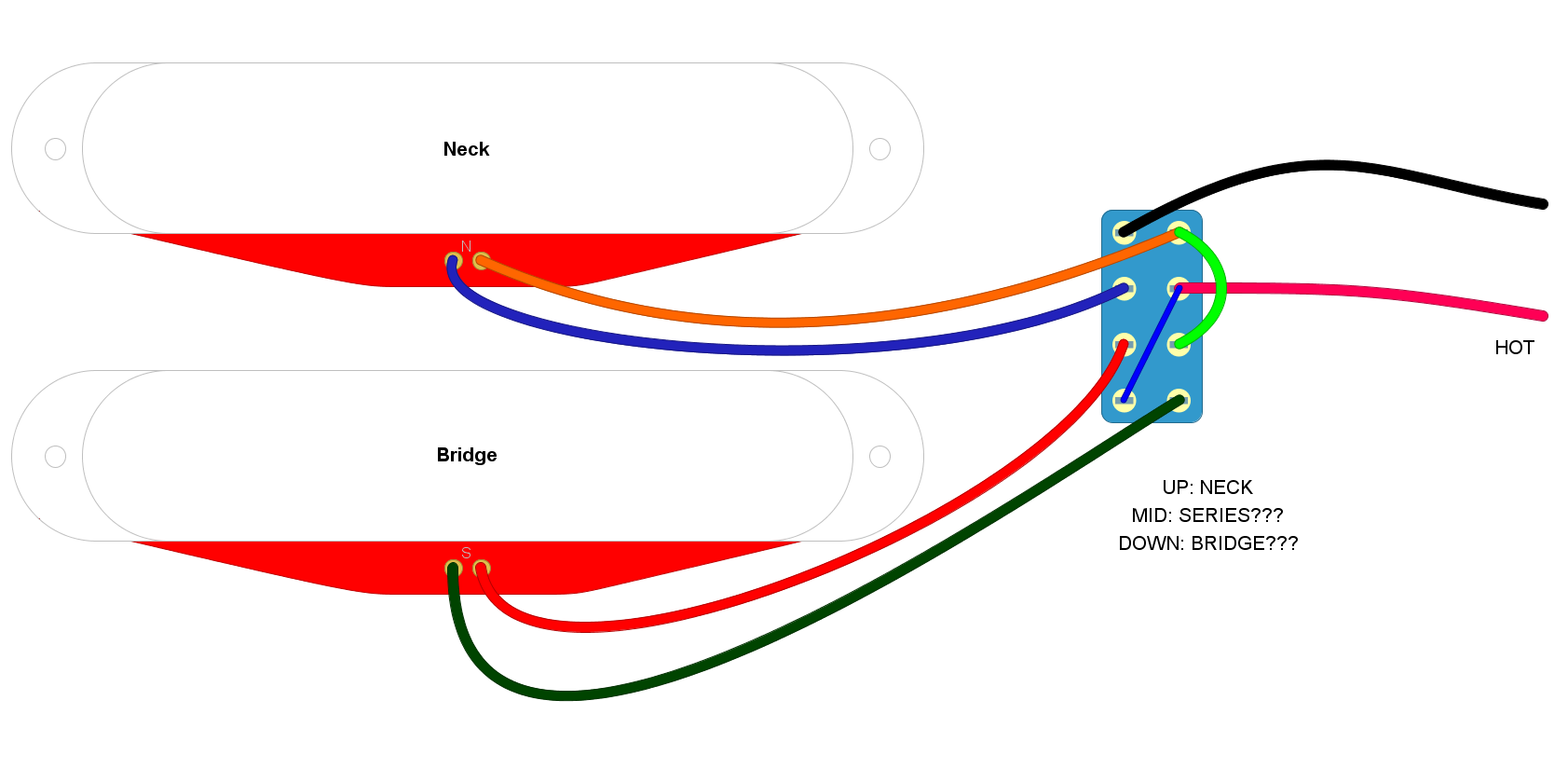

Post by yow on Apr 16, 2021 15:54:50 GMT -5
I'm trying to use a single 3-way slide switch as a pickup selector (replacing a 3-way toggle switch). I have Seymour Duncan hot rails in the bridge, cool rails in the neck. When I wired it using the original 3-way mini-toggle there was a ground wire running from the selector to the back of the volume pot and everything worked well. I've attempted to wire the new switch as shown below (I'm a newbie to guitar wiring) but I'm getting a huge amount of buzz that I believe is a grounding issue (mostly goes away when I touch the strings/metal on the guitar). reTrEaD, you commented above on what I think is close to what I'm trying to do, but that post had to do with using single coils, though I can't tell if the 3-way slide switch is being used alone as a pickup selector alone nor what the different wires are from the pickups (hot/ground?). Any help would be greatly appreciated, I've scoured the internet but can't find a solution and my guitar is in pieces on my dining room table My uneducated guess would be a ground wire from at least one of the pickups should be going to the slide switch.
Post by reTrEaD on Apr 18, 2021 13:47:36 GMT -5
My uneducated guess would be a ground wire from at least one of the pickups should be going to the slide switch. yow, the drawing you posted looks legit for SD pickups. You shouldn't need any ground wires from the pickups going to the slide switch. You should have a bare (ground) wire from each of your pickups. Those can be soldered to the back of the Volume pot along with the Green wires you already have there.
