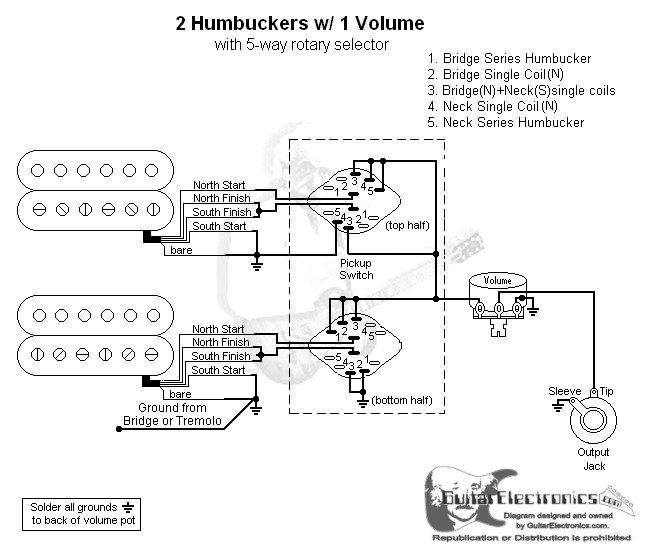

Post by reTrEaD on Feb 23, 2018 16:26:12 GMT -5
This diagram is the closest I've found to what I need but I'm still missing the second dual pickup selection. The way that arrangement is structured, it would require a lot of changes to add the two HBs in series with each other. And four coils in series is not such a great choice, in my opinion. With only six possibilities, you might want to consider something other than that. If you want #3 Neck+bridge humbucker #4 Bridge single+neck single The structure supports that. It wouldn't be difficult to shift a few things around, using that diagram as a starting point. Just grab an image or drawing of the 6-position rotary you plan to use. Single at the neck is always a good choice. Even though you can't get hum-canceling with one coil, the tone is nice. But a single at the bridge isn't as useful as something else could be. So maybe you'd be happier with something like: 1: Bridge humbucker 2: Bridge humbucker + Neck single <------- this is a nice one, imho 3: Neck+bridge humbucker 4: Bridge single+neck single 5: Neck humbucker 6: Neck single Or do you have strong feelings about keeping the bridge single?

Post by reTrEaD on Feb 26, 2018 16:34:29 GMT -5
I would wire a DPDT switch in front of the rotary that would connect the neck ground and bridge start. I know there would probably be some dead spots with that set up. Just an easier way for me to mute the guitar then. I'd also leave out the wires on the 3rd position on the bottom deck to shorts the south bridge coil and on the 2nd from the top deck that shorts the south neck coil. vF, anything that leads to dead spots is something you should probably avoid. Maybe we should look at an overall strategy that gets you where you want to go without dead spots. Here's a drawing from one of my threads in Design Modules, Guitar Wiring Design Tutorial: Strat-o-Various Project pt3: That might be a good starting point for a design with a 4P5T or 4P6T rotary and a DPDT for series-parallel. A few notes: - The pot and cap were meant to take advantage of the extra tone pot on a Strat. But they aren't necessary. They can be omitted.

Post by reTrEaD on Mar 3, 2018 19:21:02 GMT -5
Right, so the rotary looks pretty common in layout. Shouldn't be too difficult to find a drawing for it. Here's the schematic version. First drawing has each position separately then all merged together as one in the lower right. This is just the merged product.
