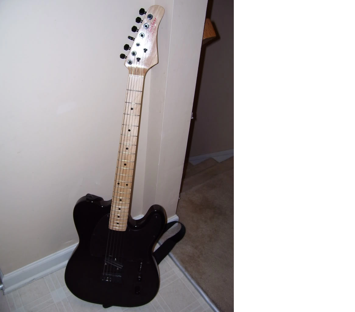

Post by newey on Apr 29, 2019 21:48:30 GMT -5
I have this Tele/Esquire-ish guitar: Which has a GFS dual-rails pickup at the bridge, wired in classic Esquire fashion, with a tone-control bypass setting and a cap/strangle "Tone at 0" setting. Ever since I built the guitar, I have disliked the pickup. It was my first experience with the 'dual rails" HB-in-a-SC-form-factor" type of pickup, and after playing with it for a number of years, I'm not a fan. I like a nice clean SC sound, and the dual-rails was rather "crunchy" sounding for my tastes. So I have decided to swap the pickup for a std. Tele bridge pickup. The guitar is a cheap POS, so I don't want to break the bank, but it does play pretty good, so I'm willing to spring a bit of $$ so long as it's not hundreds. I see a lot of so-called "hot" Tele bridge pickups, but those who know me know I'm "Mr. Clean" tone-wise, so I want something more traditional. So, a couple of questions: 1) Any recommendations for a reasonably priced, vintage-sounding Tele bridge pickup? I want nice and twangy without a huge outlay . . . 2) Question that I don't know, historically, was there any difference in Fender OEM Esquire pickups vs. OEM Tele bridge pickups? If there was, I'd like to get an Esquire one just for historical craps 'n giggles . . .

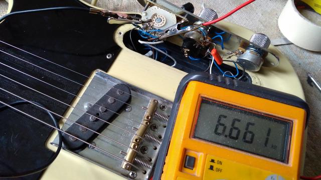

Post by b4nj0 on May 11, 2019 8:43:59 GMT -5
I have measured my 1950s Tele bridge pickup. It's 6.6K. If there is any ageing effect I wouldn't like to guess but I imagine it'd go higher than when fresh wound? Doesn't help Newey much. It's obvious to many, but does clarify that if you judge pickups only by resistance, there's quite some disparity. e&oe...
