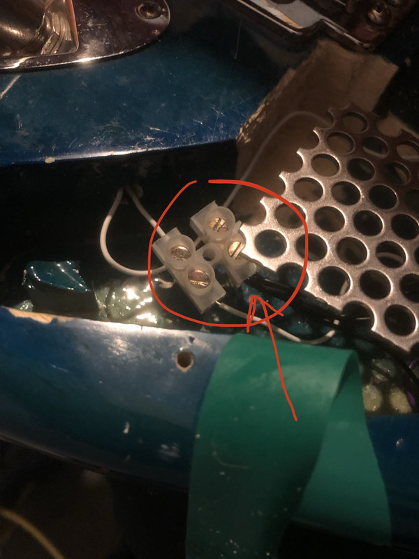

Post by ourclarioncall on Mar 21, 2020 16:39:58 GMT -5
I read the star grounding stuff a long time ago. From memory , was it just moving all the ground wires from the back of the pot onto like a washer or bit of metal? I don’t have any pots as I just have switches and am using a bit of connector block to group my ground wires together right before the output jack. its working ok but I’m running out of room as I’ve squeezed 4 wires in there already , not including the string ground as that’s hard wired to the output jack. I need space for at least one more ground if not more and there is no room left. I could use a bigger heavier duty bit of connector block as I have some But just wondering if there are any better options out there folks have tried ? Or their thoughts on the whole star grounding thing
Post by thetragichero on Mar 21, 2020 18:54:37 GMT -5
grounding schemes not nearly as important in passive guitars as in amps every guitar I've done star grounding has had way too much wire in it
Post by blademaster2 on Mar 23, 2020 14:53:08 GMT -5
Agreed. Grounding pattern importance arises over larger distances and/or where there is enough return current flowing through the 'ground' (which should have zero current) that the difference in the reference voltage from location to location causes a noticeable signal. The guitar cavity, and the current flowing, is small enough that either of them is probably okay, although in theory I expect a star ground connected only at the jack is the best configuration.
