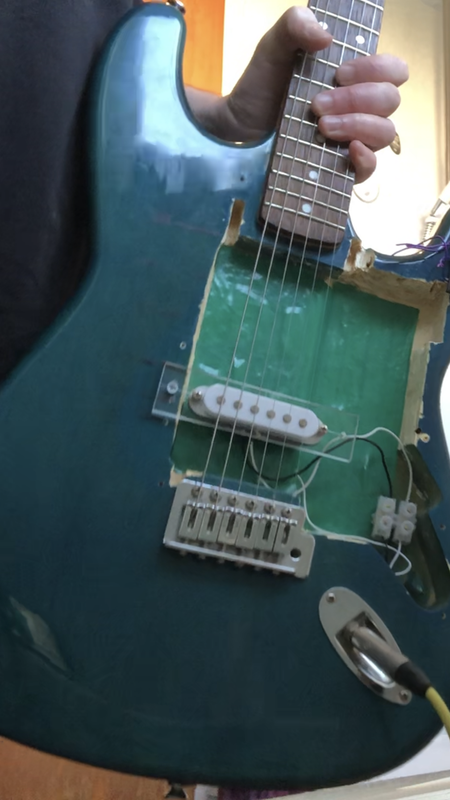

What would you charge from the original design ?
I’ve always been a strat man
But if I could change anything , I would move the bridge pickup so it’s not slanted and also a bit closer to the neck about a cm or two just to mellow out and fatten up the notes on the g b e strings
I also really dislike the input jack . The position of it, the design etc. A lot of bulk . Also how it’s separated from the cavity. In fact I’m sure there could be a much better design for the jacks themselves on the end of the cables. Combined with the input jack the whole system feels bulky , unstable , unsecure. No wot I mean ?
Maybe the bridge saddles would be added to the list. Those little screws on the saddles bearing the weight . Again , just feels unstable and something a little tone suck. On a Tele you can hear and feel the tightness of the sound and the physical feel because of the solid bridge and I think In part or mainly the barrel saddles. A strat tends to have a looser feel.
I don’t like guitar necks that move to easily , like when you hit an open low E string then bend the g string and you can hear the pitch on the low E change because of the shifting tension on the neck spread acrosss the sum of the individual string tensions . And that’s with the bridge screwed flat down, not floating
There are other things like bigger frets , flatter neck radius , but I will maybe put those into a modern custom category .
Other than that Leo did a pretty good job .

reTrEaD ” But I would consider adding another SC pickup adjacent to it. (An HSS Strat doesn't get the same tone in Bridge + Middle even when the HB is split). That would open the door to a lot of very good hum-canceling combinations.” do you mean another single coil pickup right next to the standard bridge pickup (like the Robbie Robertson strat ) or do you mean adding another single right in the middle of the middle and bridge ? i want to try both these ideas and that’s why I wants to have sliding single coils one of my ideas was to rout out a hole for a pickup right inbetween the middle and bridge , then move the neck pickup to the middle position and the middle pickup to the new “midge” position . Then you would have a couple of interesting new parallel sounds and also in series mode some unique humbucker sounds this was where I will plan to go next after finishing a 2 pickup guitar . Exploring 3 coils here’s a great vid, pity he didn’t do the series sounds tho
Post by reTrEaD on Mar 27, 2020 22:05:43 GMT -5
I mean:

Post by ourclarioncall on Mar 28, 2020 18:39:15 GMT -5
The bridge position is great .... With overdrive / distortion Or when used in a parallel or series combination Where it falls down and sounds terrible imho is when playing on the bridge pickup on its own with a clean sound. A compressor can help a lot tho Just this week I have been experimenting with moving the bridge pickup forward by a centimetre at a time and swing the pickup so it’s angled aswell as straight .... searching for the sweep spot (to my ears) , (specifically for a clean sound ) where it starts to fatten up and mellow out a little bit but without loosing it’s cutting bite. i made a few marks on the body, for example the position where the pole under the thin E string would have been on hendrixs strat , as well as putting the pickup bang in the middle of the middle and bridge . You could call that the “midge” position and Hendrixs we can call “hidge” 🙂 I settled on the position in the pic but can’t remember where it was now. I made a demo vid with a really cheap amp in my bathroom but the amp is pretty bad so you won’t really get a good idea of what this adjusted position sounds like. If I get a better amp I could do a few comparisons

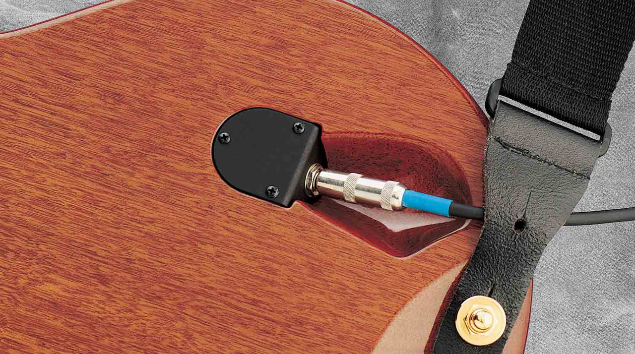

I'm thinking of using a strat jack plate on the side or (probably) back of my Jaguar bass build. I've seen a couple of expensive basses that have interesting recessed jacks on the back and i like the idea
Post by sumgai on Mar 30, 2020 11:29:57 GMT -5
I'm thinking of using a strat jack plate on the side or (probably) back of my Jaguar bass build. I've seen a couple of expensive basses that have interesting recessed jacks on the back and i like the idea Brian Moore Guitars has been doing this for more than 20 years: I've personally handled only two of these expensive guitars, they play like a dream come true. But better bring two checkbooks, 'cause you're gonna need 'em both. HTH sumgai
Post by newey on Mar 30, 2020 11:39:41 GMT -5
The benefit being what, exactly? Seems like having the cable up against one's body, as one moves while playing, would be more likely to stress the plug's connections and cause the cable to fail than if the jack is on the front or the side.
Older guitars, with the jack on the front, resulted in the cable/plug sticking straight up. Which was the reason for right-angled plugs, as well as for the Strat jack-canoe. My Duo-Sonic has the flat front-mounted jack and I've been meaning to get a cable with a right-angled plug for some time because of that.
