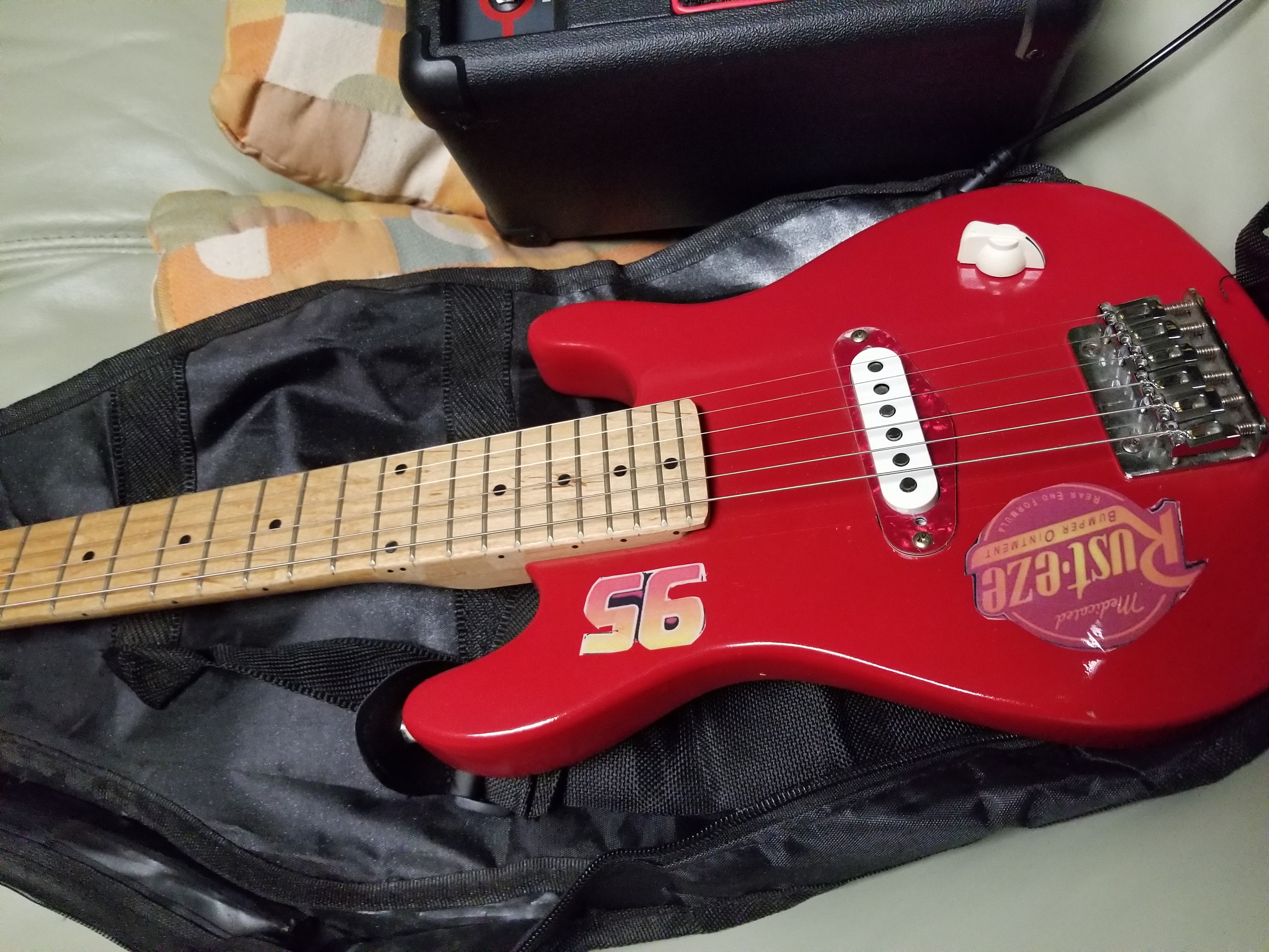

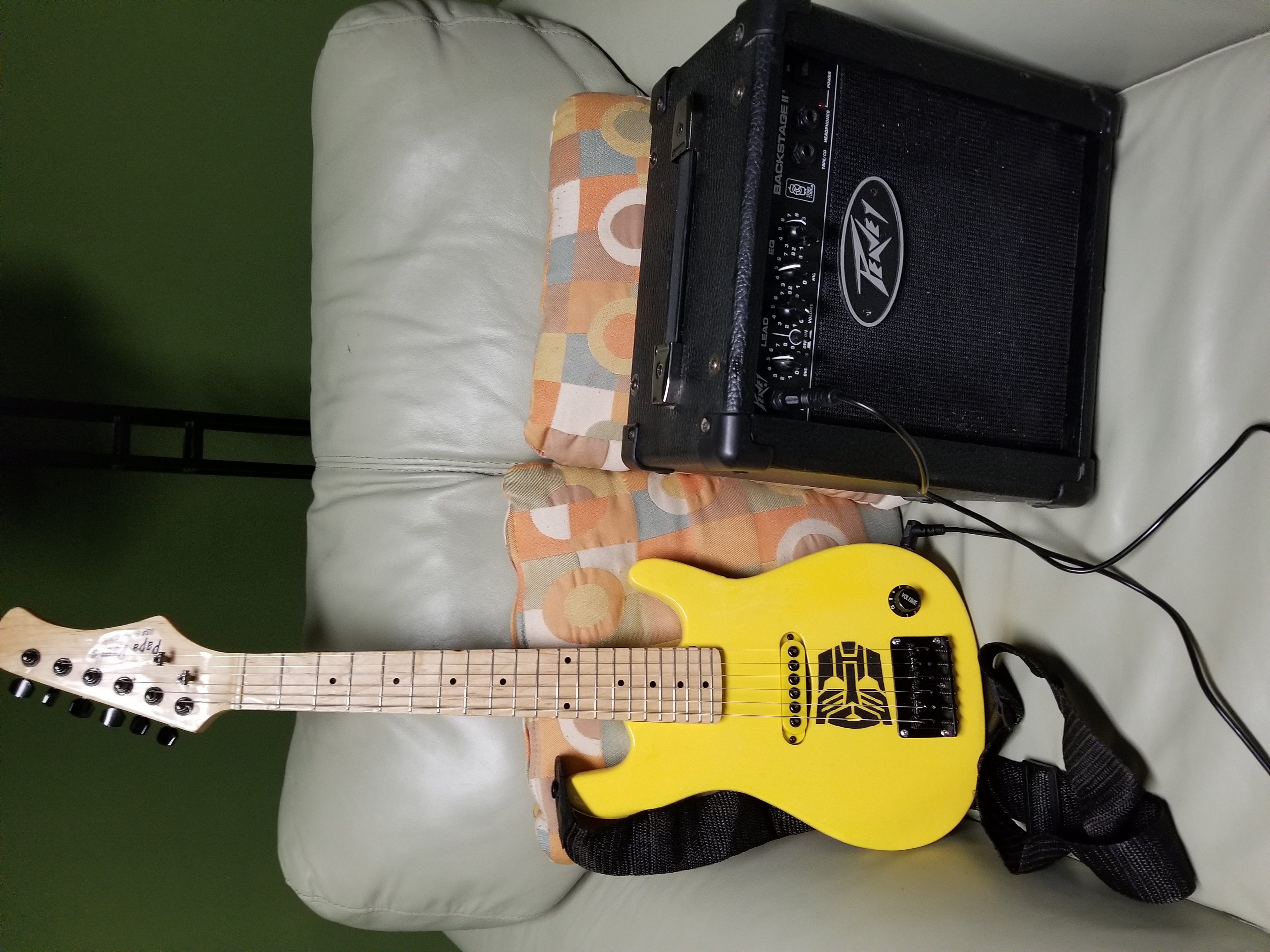

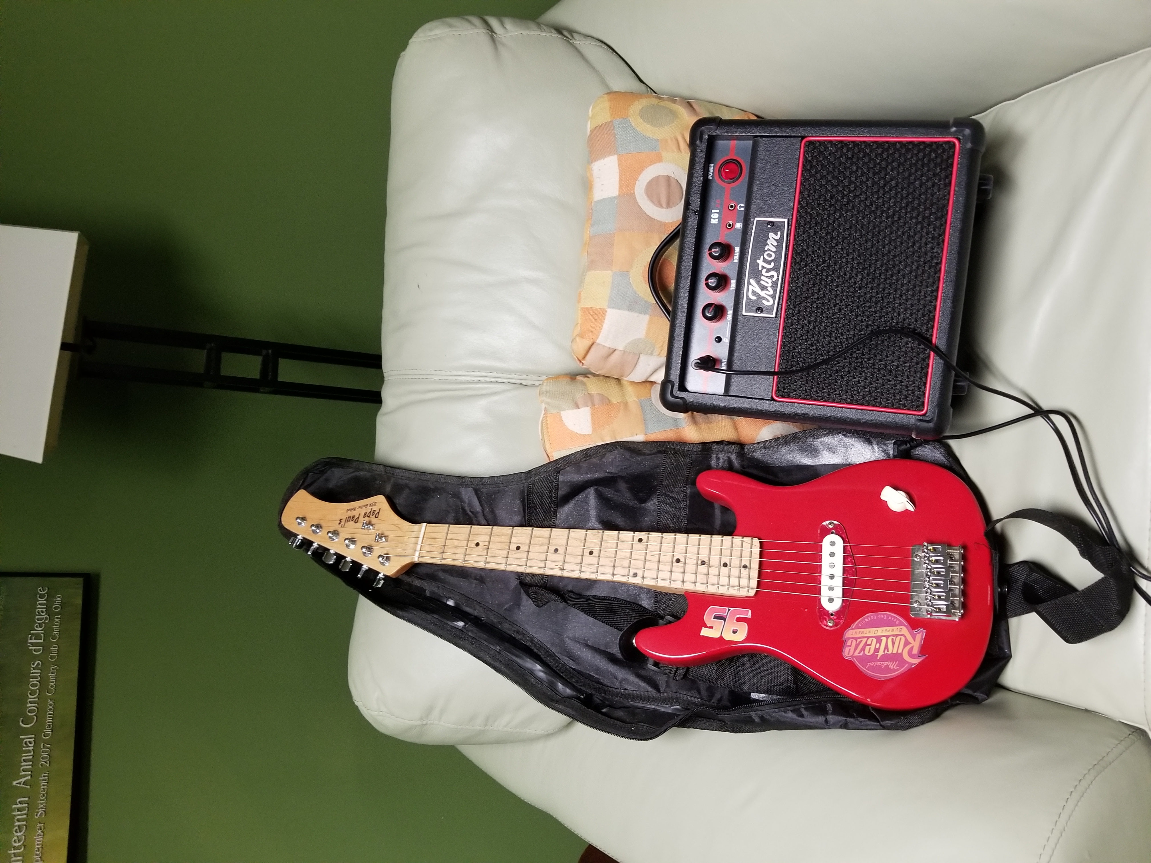

So, around Xmas I was tasked by the son-in-law with coming up with guitars for the two youngest grandsons, aged 3 and 4.5. I got a pair of 1/2 size kid's guitars, both were black, one was $20 on Ebay, the other was $22. And I picked up a pair of practice amps for about $25@. One was branded as a "Sky", the other as a "BC". They were basically identical: The elder of the two is a big fan of the Disney "Cars" movies, so his guitar got the "Lightnin' McQueen" treatment. With a Kustom Amp with matching red piping, no less. The younger grandson likes the Transformers, so he gets the Bumblebee-themed one, with black hardware, and a Peavey amp. They're getting these delivered (touch-free) tomorrow in time for Easter Sunday. The noise level is, luckily, their parents' problem. That's the great thing about being a grandparent . . . W1th the very short scale of these, I tuned every string up one from concert tuning, i.e., A-D-G-B-E-E, with the high strings in unison like a 12-string. Taking the 1st string up further would be a bridge too far with light gauge strings. But I'm looking for alternative tunings for these things

These were butt-simple builds, but I had fun with the decals and refinishing. But I also learned a valuable lesson. In the past, when doing a rattle-can paint job on one of these cheapie plastic-coated things, I had always sanded everything down to bare wood, then primered it, sanded the primer, etc., then several finish coats, then clear. Sanding the bodies I did outdoors, in good weather, due to the mess involved.
This time, since it was winter and I was indoors, I decided to just sand the existing finish down for paint adhesion, without stripping it all the way off. BIG mistake! I had a devilish time with painting, with paint incompatibility and orange peeling. In the end, I basically had to do both over again, and the second time I was basically almost down to bare wood anyway. Not my best refinishing job, OK if the kids don't look too closely at it.

Love the transformer decal , really pops out with the yellow . Great job 👍
