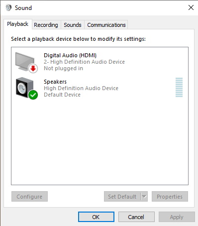

Because it needs WDM Kernel-Streaming to effectively run the device with the DAW. You need a work around. Here is a link that should give you what you need. www.asio4all.org/One must set the usb interface as the default playback device. Then all goes to the headphone jack.
