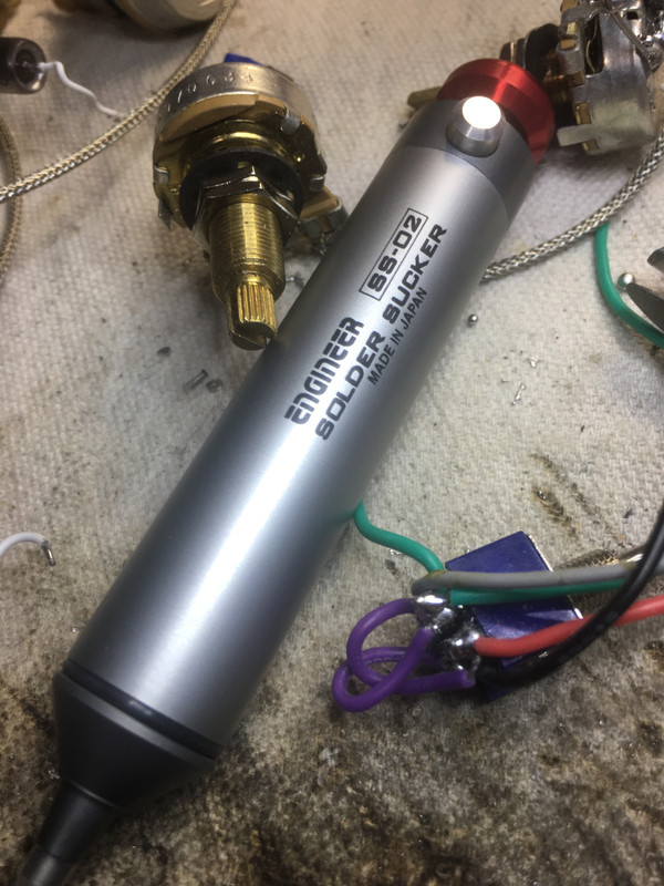

Guys, I have lamented several times about easier solder remover. I’ve got good flux, plastic solder suckers from China, bulbs and still whined until I received this as a present from a fellow luthier. It’s built like a throwback to the 60’s. A tank. All metal, precision built and from Japan. It’s a solder beast, removes gobs of solder in one suck. It will last 100 years. It’s called an “Engineer - SS-02 Solder Sucker”. I googled it and found that it’s $23. Ouch! But if you do what I do, this is highly recommended.

i use the little bulb type to get the big globs off and then copper braid with flux (the expensive kind already has flux in it. the cheap kind i buy a ton of does not) for the finer stuff

I have used many types of solder removal tools during my earlier career years, from bulbs and spring-load suckers to braids to electric, vacuum operated stations. I hated the bulbs and spring-loaded ones because they induced motion or kick that was not conducive to finer circuit assemblies (but they might be fine for guitar circuits). The expensive station worked well, but became clogged far too often and needed a lengthy cleaning process (after it cooled down enough).
If that tool is well built and does well in guitar cavities where the parts are large and the amount of solder is also large, then that is great to hear - and the price is quite reasonable.
My preference is still solder braid, with a drop of liquid flux added to it. I have achieved excellent results that have been as good as any other tool has achieved, and some of those results are orbiting the Earth right now.
