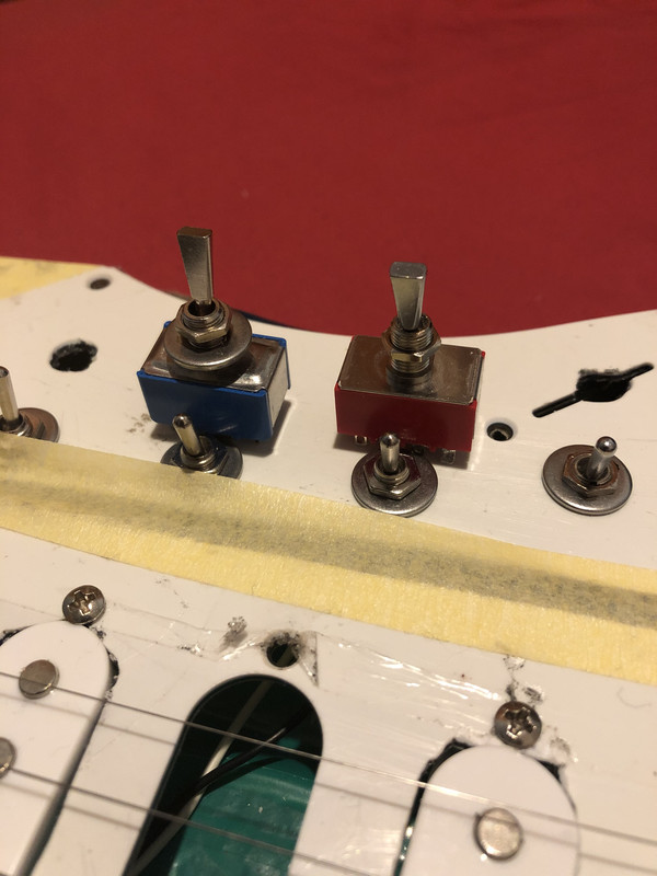

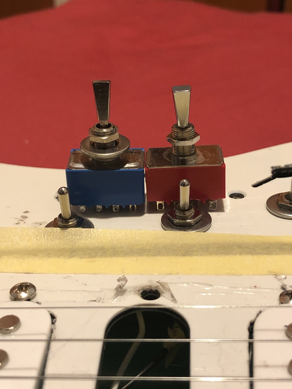

Would it be okay to have these 4PDT switches right up next to each other when installed in the pickguard ? (See first photo below) Would the metal casing on them touching each other cause any problems ? i don’t mind leaving a little gap but I’m trying to get the toggles as close together as possible . Maybe it would also keep the switches more stable and prevent them rotating as much over time And constant switch flicking.

Would the metal casing on them touching each other cause any problems ? There should be no problem with that. Ideally, you'd have foil on the back side of your pickguard which would put the cases all at ground anyway. If there is any electrical connection between any of the lugs and the metal case, that would be the result of failure (due to overheating while soldering).

yep I agree, you could even butt them right up against each other, it'd keep them square in line, better than locking washers.
The contacts on these switches are not connected to the case.
