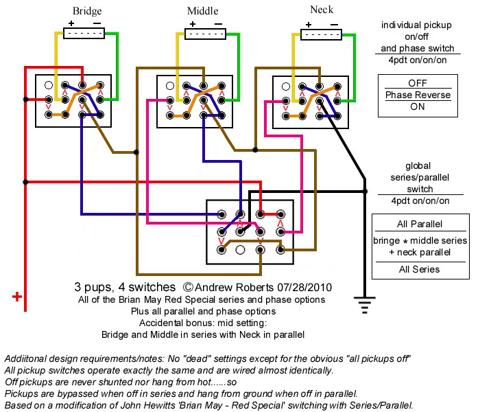

Post by ourclarioncall on Jul 31, 2020 22:59:33 GMT -5
The switch at the bottom of the diagram is a 4pdt on-on-on which gives .....all series/ bridge*middle+neck /all parallel i would prefer not to have the middle setting (bridge*middle+neck) and just have the other two options of either ...all series or all parallel so I was wondering if I could just swap the switch to a 4PDT on-on instead of the 4PDT on-on-on ? Without changing any of the wiring, just changing the type of switch it doesn’t seem like it would be a problem as the up and down throws on the on-on would just be the same as a on-on-on Maybe I’m missing something tho this is one of Yogis refinements of Andrew Roberts/JohnH circuit. The one used by solderburn
