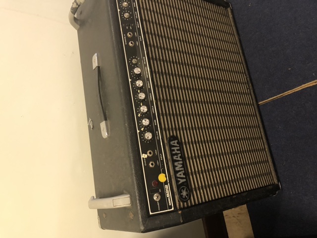

Where I take lessons, my instructor uses one of those Super Champ 2s(not that he has a choice, it's what's in the practice room). I, on the other hand, get to plug into a nice old Yamaha 2X12 solid state amp. For my money, those old Yamaha SS amps are the best-sounding SS amps ever made. Not one of these is it? I found this amp today at work.
Post by thetragichero on Oct 20, 2020 11:37:05 GMT -5
those old yamaha solid state amps are great. I've had a b100 on my reverb watchlist for awhile. nice little amp but i have no need for yet another
Post by newey on Oct 20, 2020 11:49:09 GMT -5
Not exactly that model, but very similar to the picture.
Post by ourclarioncall on Oct 20, 2020 12:04:16 GMT -5
Yeah, I think these can fetch about £400-£500 which I was really surprised about.
unfortunately this one has something wrong with , it was years since I plugged into it, it just sits doing nothing . You jogged my memory when you mentioned ss Yamaha amps
