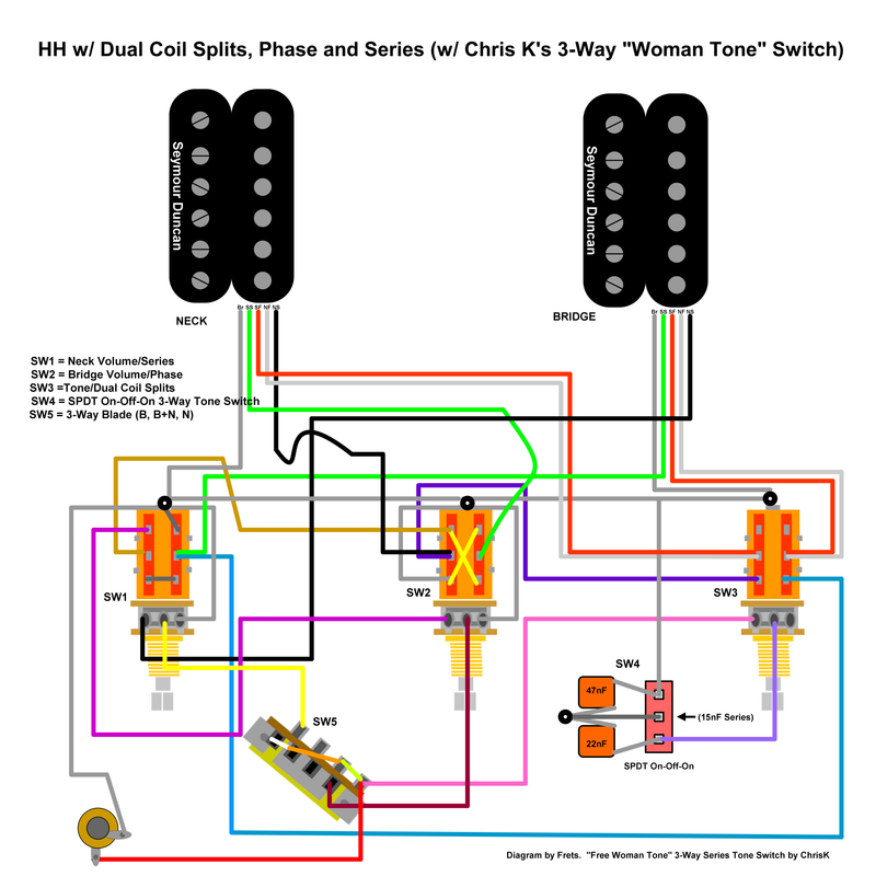

Post by frets on Dec 20, 2020 17:40:21 GMT -5
Hi Guys ❄️❄️ Last time I posted, I was working with used Bumblebees, and thanks to Newey, he correctly identified the 3-Way On-Off-On 2 cap seriesed mini tone toggle as the “Woman Tone” Switch invented by ChrisK, I thought folks out there might like to see how it can be used. I just finished an HH Strat with Dual Coil Splits, Phase and Series with the ChrisK’s 3-Way mini Tone Switch. This is a very powerful setup and of course, can be used with any 3 control HH guitar.
