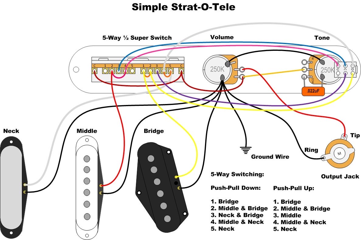

Hi Txspecial, Since this is a Tele you want to mod, you might try one of the “Strat-O-Tele” wiring diagrams. I believe there are a couple of Strat-O-Tele diagrams on the forum. This one is the most simple.

And Yes i have had my eye on a few diagrams Phostenix had put together.
