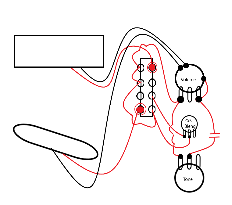

Hello Thought I should share this. I've added this to my Tele style guitar as a way of dialling in the telecaster mid position sound when you have a neck pickup that overpowers the bridge, like with a gold foil neck or a P90 (where splitting the pickup isn't an option).
