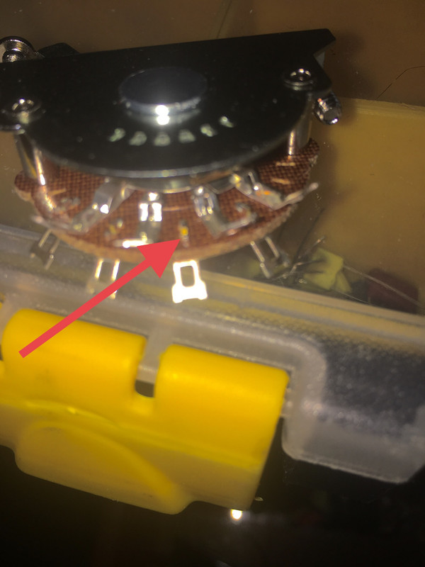

Hi Txspecial, I am so sorry you’re stuck in this dilemma. I have done this in the past and it will get you at least an 1/8th of an inch. It’s a bit radical though. On each wafer, the Switch lugs are physically attached whereby each lug attachment is protruding from the other side of the wafer(s); i.e., the little prongs holding the lug on the wafer. For clarity, I use a regular switch to illustrate what I’m talking about. The red arrow is pointing to a set of prongs for a lug. On a Superswitch you just have another wafer with the same. You cut the lugs, sand the wafers down by a 1mm or so. You then use a thinner wire like a 26 AWG and solder your wires directly to the protruding lug prongs (cloth wire will not work). So, to recap, lugs are cut, wafer sanded down a bit, and wiring is done on the exposed prongs. It’s a tricky solder but can be done.

Thanks, I actually did do something similar to this before i read the post, but it wound up working out , i also bent the metal part of the swith that has the screw holes in it, i bent it to where the metal was touching the wafer and there was no gap on one side. Looking at the switch it will be bent on the top sidebut the part that butts up to the control plate is still squared. Doing this actually did create more room, both by closing the gap, and it also caused the witch to mount at a slight angle inside the cavity. BE it just a few degrees..it seemed to really provide alot more clearance. Just had to make sure to re route the wires behind the switch. Worked out great IMO.
