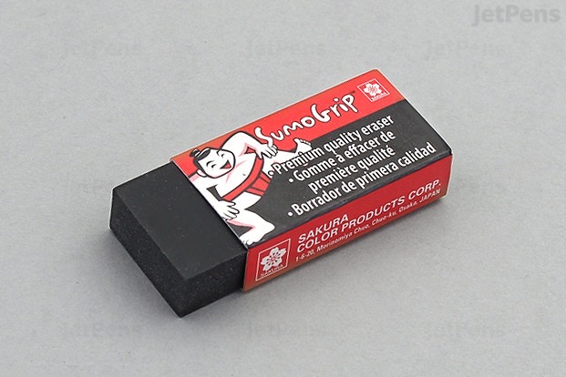

Hi Pablo, I assume this request is about single coil slugs? Before you attempt the heart palpitating, 💔 nerve wracking process of attempting to remove pole pieces, have you considered attempting to clean the rust off the pole pieces? If not, and if it’s your aim to remove the rust, a really great way to get rid of rust on a pickup pole is to use a top quality art eraser. You can find them at a craft store (Hobby Lobby, Michaels, JoAnne’s). I find Sumo Grip erasers to be superior for removing rust off of pole pieces. With just a little bit of erasing, the rust will disappear!!
