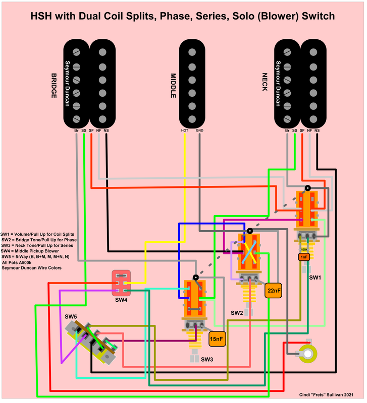

Morning Guys, This one is an HSH. I don’t get to do many HSH guitars. With this one you have Dual Coil Splits to the Humbuckers, a Bridge Tone of 22nF (pull up for phase), a Neck and Middle Tone of 15nF (pull up for Series), and a Middle Blower (Solo Switch). Placing the blower in the middle pup position provides a nice push through in the B+M, M or M+N positions. The switch is an On-On
