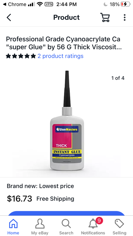

Post by frets on Apr 16, 2021 14:06:46 GMT -5
Hi John, I was looking for something else on my shelves today and saw my other super thick super glue that I use for dings that are not gouges and more superficial. It’s thick and sets fast and you can buy it on EBay. the Dap Rapid Fuse I mentioned has the advantage of being worked before it sets. It’s still fairly thick and will not dry as fast on you. I use the Dap for gouges where I mix sawdust and shape the repair. But it could be used by itself for a ding. I just thought you should know my two choices that are readily available.
