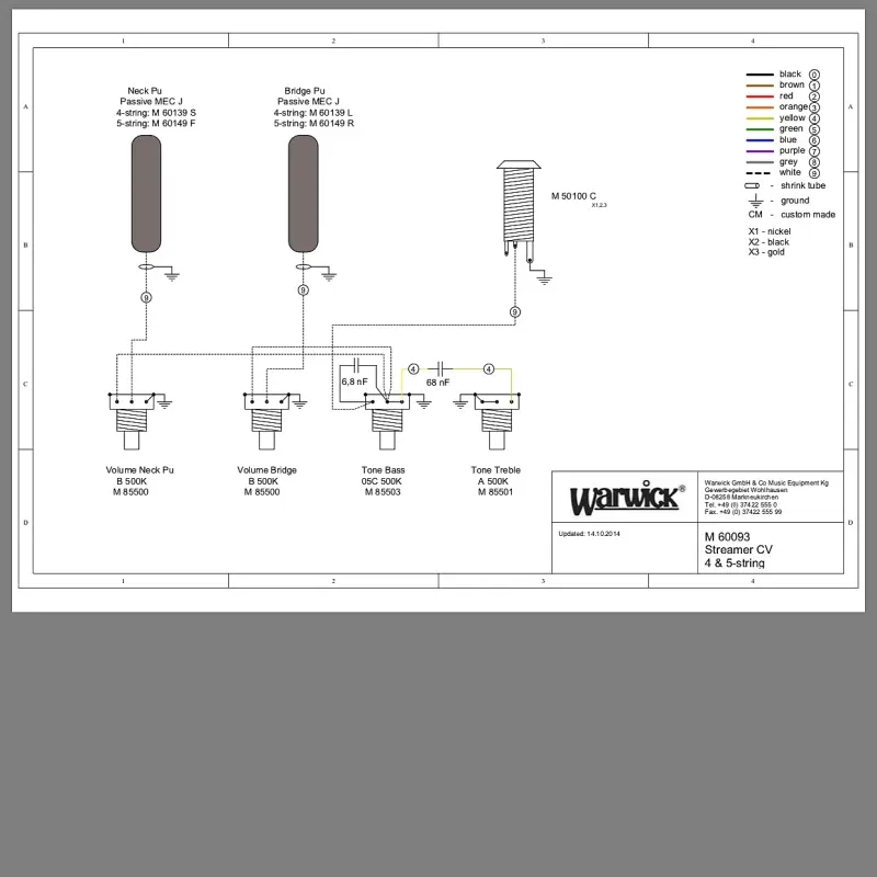

I stumbled upon this Warwick Streamer CV bass that has an unusual control layout for a passive bass: Volume Neck/Volume Bridge/Treble/Bass Here's the wiring diagram:

Fine to post this here for discussion, no problem, but please also re-post this in our collection of OEM wiring diagrams, which is a sub-board under "Guitar Schematics". Someone who is looking to rewire their Warwick Streamer will likely look there for the info rather than here. We are trying to build up a reference source for OEM diagrams, some of these factory diagrams for older models are quickly disappearing from the web.
