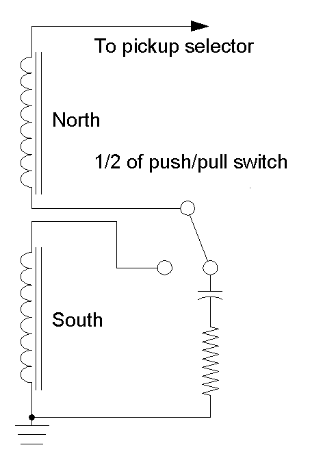

1. TDPRI Partial Coil Split Theory and Discussion
Great straightforward explanation and diagrams here. Moosie mentions the PRS partial split method they use on the S-2 and Core HH models - a simple resistor shunt of one coil. He also mentions a method tried by Gibson - just a capacitor to shunt across one coil.
The interesting thing about Moosie's approach is that he uses a bass cut cap between the coils and then uses a simple resistor shunt to either hot or ground to attenuate the desired coil in the humbucker.
Moosie has done a lot of work on experimenting and listening (including building test rigs) and I think his approach is a great starting place. I have built this into one of my project guitars and it does work. (Really well, but I'm in love with approach 3 below.) Hats off to Moosie. Whether Moosie knows it or not, he's in the GNuts2 tribe.

If you are doing total or partial coil splits on both PU's with one switch, you have two pickups from the same manufacturer, and you want, let's say, the north coil on one humbucker and the south coil on the other humbucker to be active, you normally split one PU to hot and one PU to ground.
If you want to split both PU's to hot or ground, use north coil of one pickup and south coil of the other, and retain some hum cancelling when both bridge and neck are selected and the split is active, you will need to wire one of the PU's "inside out."
("Inside out" may seem confusing; what you really do is "re-stack" the coils from ground to hot, but "inside coil split point wires go to outside and outside wires become new split point" is definitely too long.)
Here's a good, well-written link with text and diagrams to explain this idea. It uses DiMarzio pickup color codes but you can easily understand and translate this to other PU manufacturer's products.
Flipping the magnet together with inverting the polarity of the pickup hot/ground connections would do the same thing as "inside out", but with the big disadvantage of having to open up the pickup.
