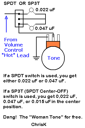

Post by ChrisK on Jan 8, 2009 19:01:05 GMT -5
tedfixxIf one connects two tone caps this way, and uses a SP3T (SPDT Center-OFF) switch, one gets 3 cap values. Any cap values can be used, the center (series) position value will be 1/[1/C1 + 1/C2] or C1 * C2C1 + C2

If one connects two tone caps this way, and uses a SP3T (SPDT Center-OFF) switch, one gets 3 cap values. Sorry I'm new to this where do the caps go to. Do they all wire together with center lug. or do they all go to a common ground and sorry if this is a stupid question. Any help would be appreciated.

The caps are shown in ChrisK's diagram above as little circles. One end of each cap connects to the outermost lugs of the switch. The other end of both caps connect together at the center switch lug.

zar- Hello and Welcome to G-Nutz2!The caps are shown in ChrisK's diagram above as little circles. One end of each cap connects to the outermost lugs of the switch. The other end of both caps connect together at the center switch lug. Thank you. That helps. Can't wait to try it out.
