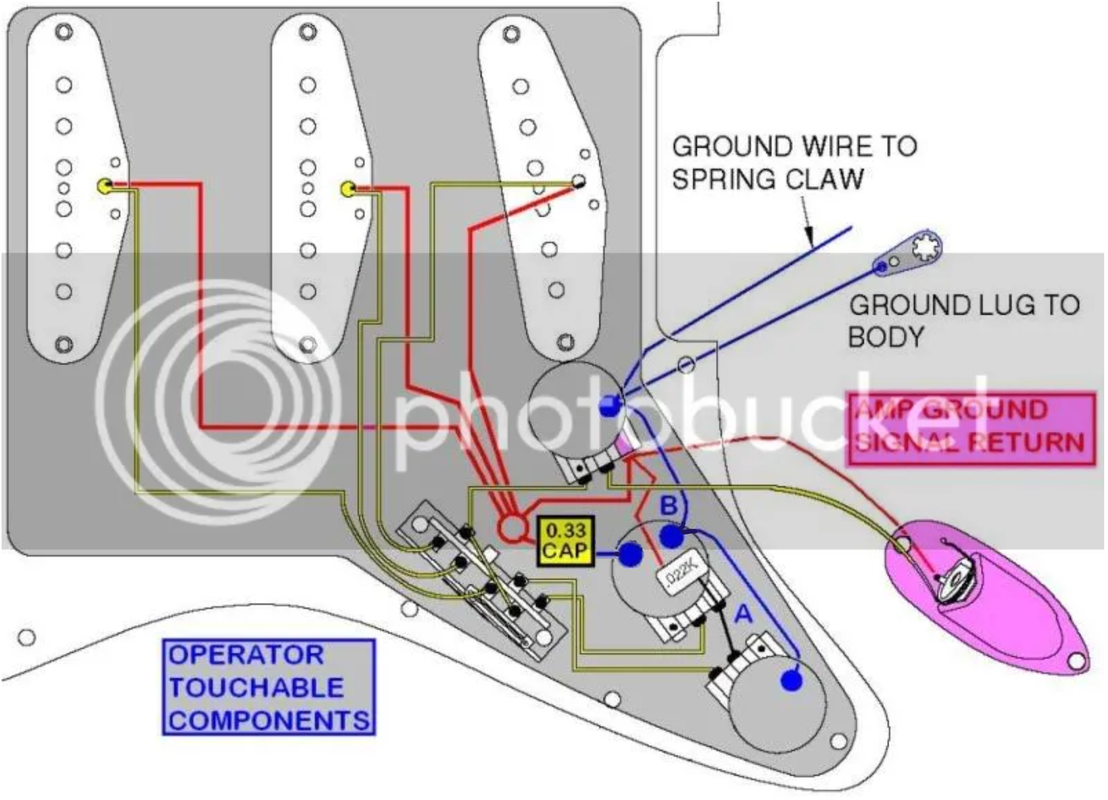

The first picture shows the effective grounding in a modern Stratocaster. Note that all three pot back shells are jumpered together. This costs money to do and Fender makes a lot of Stratocasters, but they feel that this is an important step. It is.
The shield foil on the pick guard is a shield, it is not a reliable conductor. One does not depend on a shield for use as a conductor. Unfortunately, in a guitar cord, the shield is also a signal conductor, but that's another sad tale.
Note that these jumpers are often called a "ground loop" because they are both "grounded" and "loopy". Ground loops can be a bad thing when they actually affect a signal.
The jumper marked "A" connects both tone pot shells together. These are also (hopefully) connected by the foil on the pick guard. On the lower tone pot, no circuit component is actually connected to the pot shell, so the jumpering of the tone pot shells together ("A") in parallel with the pick guard shield connection CANNOT be a meaningful ground loop since NO signal current flows between either. Period.
The jumper marked "B" connects both the volume pot and the neck tone pot shell together. These are also (hopefully) connected by the foil on the pick guard. The only signal current flowing between these two points is from the tone control capacitor signal return. While this point would properly be connected to the back shell of the volume pot (THE existing star ground point), the shortcut of connecting it to the tone pot back shell is used for historical reasons. Did I mention that these shells are also connected by a factory-installed wire jumper? These points are within 1 - 2 inches of each other. No appreciable current flows through the shield (it's a shield, remember). This small "loopy" circuit connected to "ground" is not a meaningful ground loop. It does not need to be removed.
Note that all "grounded" circuits and components are connected to and are part of the circuit known as the AMP GROUND SIGNAL RETURN OPERATOR TOUCHABLE COMPONENTS. If something happens in the amp or with the mains wiring/safety ground, the operator will be in direct electrical contact with this point.
If your guitar is wired this way, you absolutely should use an outlet tester every time, use a GFCI cable every time, and use wireless every time.
The second picture shows the separation of the AMP GROUND SIGNAL RETURN from the OPERATOR TOUCHABLE COMPONENTS. Note that all internal "grounded" circuits and components are connected to and are part of the circuit known as the AMP GROUND SIGNAL RETURN. However, all external OPERATOR TOUCHABLE COMPONENTS are connected to the AMP GROUND SIGNAL RETURN through the 0.33 uF 600 VDC capacitor (8,000 Ohms at 60 Hz). If something happens in the amp or with the mains wiring/safety ground, the operator will only have capacitively coupled electrical contact with this point.This is better. Not best, just better.
Even if your guitar is wired this safer way, you should still use an outlet tester every time, use a GFCI cable every time, and still use wireless every time.
