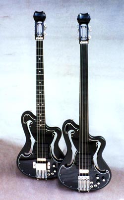

Just so you don't lose any sleep wondering, ash, it was an Ampeg "scroll bass" (or a copy thereof). In the '60s, Ampeg made both a bass guitar as well as an EUB version. If you want one now, there's a guy in SoCal who'll make you one for the right price: www.xstrange.com/
