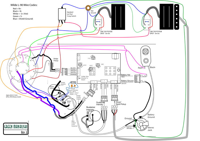

Post by cynical1 on Nov 13, 2011 3:21:51 GMT -5
I couldn't sleep, so I figured I'd rough out the drawing with the 6 pole Alpha switch.  I apologize for the rat's maze drawing of the wiring to the not to scale rotary switch. If I have the switching logic correct, and I didn't screw up, position 1 gives me only the passive side, and position 2 gives me the active side. Both sides are segregated and life should be good. I'm going to sleep now. Nyquil good... Happy Trails Cynical One
Post by ashcatlt on Nov 13, 2011 14:13:49 GMT -5
I've mentioned it before, and you might have figured it out already, but those round shaft switches don't fit knobs made for knurled shaft pots. If you take a normal plastic strat knob and ream it out with a 1/4" drill bit they fit tight enough to turn the switch without slipping. You can also ream out the metal knobs with set screws (Tele, etc) but you want to go a little bigger than 1/4" or else you have to beat them on and will never get them off. Don't ask how I know that!

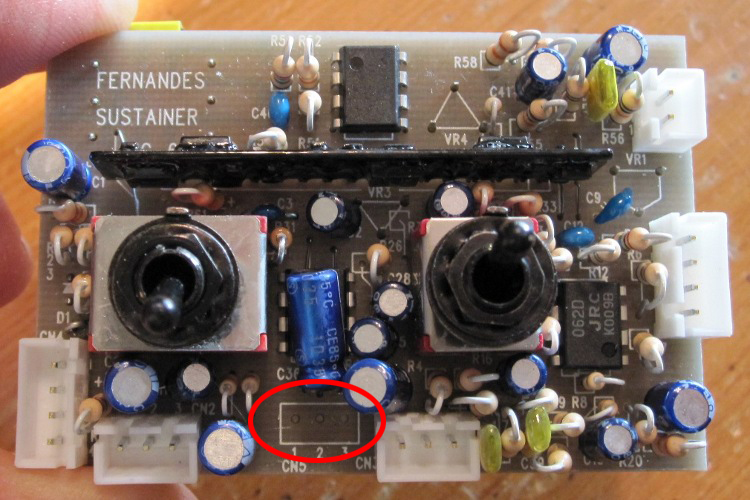

It's been a while since I looked at this, but the intensity pot is either already on the board in the form of a receptacle connector, the three points of connection are etched, but the connector is not soldered in, or, in the case of the Rev 1 boards, it just ain't there.
As far as mix mode...well, unless you know something I don't know, the sustainer board is in the circuit or out of it. There is no happy middle ground I could find. By design, even when the sustainer function is not engaged, the controller board needs to be powered up to get any output.
My intent with this mod was to be able to take the sustainer completely out of the circuit, or add it in at will. I had plan on powering this via a phantom power scheme...which is still in the works. I wanted to be able to play the guitar without the sustainer circuitry in a strictly passive mode. By design, you can't do that with the Fernandes sustainer.
The toggles on these tend to be soldered right to the board. Some of the older designs had a separate toggle connected to a second board.
I discovered during my research on this project that the configuration of these boards varies quite a bit. If you can put up a picture of the front and back I might be able to help you out.

Mix Mode seems to be a mix of the 2 other modes actually: normal+harmonic. Here are some (almost) better pictures of the Sustainer board that were sent to me today (..) - any way i can connect a pot to this so that i end up with that needed Intensity post? - do the toggle-switches seem easy to replace with push-pull knobs?
Post by cynical1 on Jun 2, 2013 11:13:04 GMT -5
Mix Mode seems to be a mix of the 2 other modes actually: normal+harmonic. Here are some (almost) better pictures of the Sustainer board that were sent to me today (..) - any way i can connect a pot to this so that i end up with that needed Intensity post? - do the toggle-switches seem easy to replace with push-pull knobs? OK, now I gotcha on Mix Mode...I saw it as "Either\Or". I put a circle around the spot on the board there the Intensity Pot connects into the circuit. A while ago SG and I had a PM conversation about the best way to add a pot to this board...but his preferred method escapes me at the moment. With luck he'll drift back here and add that in.  As to your question of pulling the existing switches soldered to the board and replacing them with push\pulls...hmmm. You might get away with it on the Sustainer On\Off switch, provided you could unsolder the existing switch and resolder your wire connections back into the board without damaging said board. Personally, I wouldn't try it, but your skills at desoldering and soldering on boards may far exceed mine. For the Mode Switch, you're looking at the problem of not enough poles on a push\pull to make it happen...so unless someone knows something I don't about exotic push\pulls, I don't see that as doable. If your board ever fails, Fernandes will replace it for a charge. When I sent mine in a couple of years ago it was on $60.00. I would personally not want to ditch this warranty option to add push\pulls...but then again, I don't like push pulls anyway... Does that help? Happy Trails Cynical One
