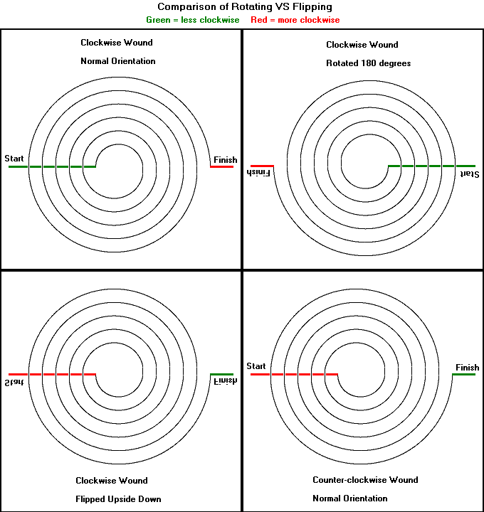

Below is a comparison of rotating a pickup (no effect) and flipping it (effectively changing the winding direction).

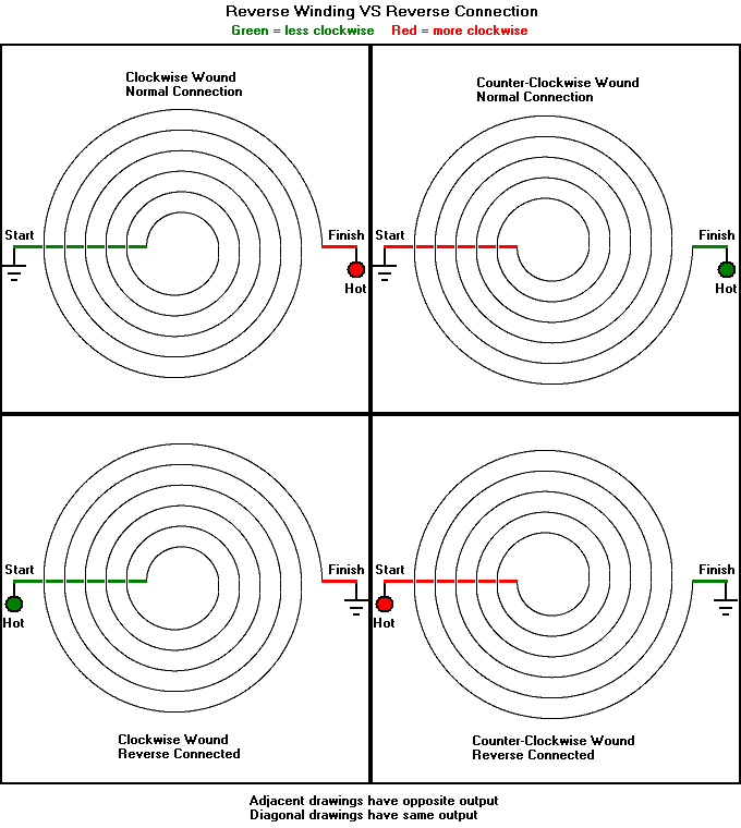

Below is a comparison between Reverse Winding (or flipped coil) and Reverse Connection.

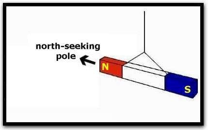

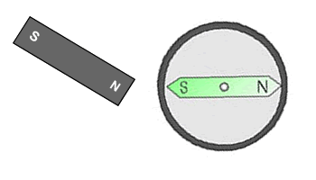

What does North mean?When we speak of magnetic polarity, North is short for "North seeking pole". If we suspend a magnet freely, the end, edge, or face of the magnet that faces north is the "North seeking pole" or simply "North". In this drawing North is toward the upper left:  Opposites AttractThe indicator needle on a compass is a magnet. If we put two magnets in close proximity, they will align North to South. Note that the North end of a magnet will repel the North end of the compass needle and attract the South end of the needle.  Attachments:
