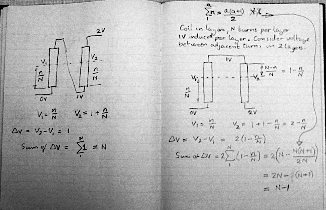

Post by aquin43 on Feb 10, 2021 10:57:49 GMT -5
I tried a little calculation to see if there would be a major difference in effective capacitance between the two different winding methods. I assumed that the physical capacitances, turn to next layer adjacent turn, would be equal to one another and the same in both configurations. The effective capacitance would then depend on the voltage difference across each physical capacitance. For the sake of simplicity I assume identical layers with 1V induced from end to end of a layer and consider only the capacitance between immediately adjacent wires in two layers. This needs a diagram and a sigma sign so to save effort I scribbled it down and photographed it. Given the assumptions made, I see no practical difference with a reasonable number of turns per layer.

Post by aquin43 on Feb 16, 2021 11:11:27 GMT -5
Warning/Apologies: there's plenty of math(s) ahead so you'll need to be using the desktop site if you want to view it rendered out. If there was an error in your math, I wouldn't know it Well I think there is, but I also don't think I understand what aquin43 is trying to show. I believe the summations should be over the range 0 to N, not 1 to N. My original idea was that there are N turns in each layer, numbered n = 1 to N. Each turn has a mean voltage across it of 1/N volts induced by the uniform alternating magnetic field. This means that even turn 1, which is connected to zero volts, has non zero voltage. I sum from 1 to N because there is no turn zero. The distributed capacitance between the layers is assumed to be uniform in structure so that it can be reduced to a series of equal individual capacitances between corresponding turns in the layers. The currents flowing through these capacitors will be proportional to the voltages across them. The capacitor currents are tacitly assumed to be small enough not to cause a phase shift across a layer so that all voltages are in phase. It is assumed that the only way that a capacitor affects the network it is connected to by drawing a current, which leads to the assumption that the voltages across the capacitors can act as a proxy for their effective values.
One could turn this discrete model into a continuous one by unwrapping the coil as you do into two parallel strands. Without loss of generality, let the total length per layer be 1 and the distance along the length measured from the start of the first layer be x. We would then integrate x from 0 to 1.
The integrated voltage across the uniformly distributed capacitance would act as a proxy for the capacitive current drawn, making it a relative measure of the effective capacitance. We would then have Normal case: V1 = x, V2 = 2-x, delta V = 2(1 - x)
1 1 integral 2(1-x) = 2[ x - x^2/2 ] = 1 0 0 Foldback case: V1 = x, V2 = 1+x, delta V = 1
1 1 integral 1 = [ x ] = 1 0 0
The capacitive current is the same in both cases.
Edit: 17 Feb
Although the average voltage differences between layers are the same, the two distributions of these voltages are very different so that the assumption that the capacitive currents don't affect the voltages along the wire becomes crucial. This assumption may not be valid and more detailed modelling may be required.
Post by Yogi B on Feb 17, 2021 21:53:38 GMT -5

Post by aquin43 on Feb 18, 2021 5:23:20 GMT -5
My original idea was that there are N turns in each layer, numbered n = 1 to N. Each turn has a mean voltage across it of 1/N volts induced by the uniform alternating magnetic field. This means that even turn 1, which is connected to zero volts, has non zero voltage. I sum from 1 to N because there is no turn zero. What's so special about the first turn? The last turn is connected to 2V, yet (in your calculations for the "Foldback" style) you count its voltage as 2V, not some value strictly less than 2V. Additionally, what's so special about the first turn of the first layer? For the "U" style winding the first turn of the second layer is where you have n = N, and your calculated voltage is 1 + (1 - N/N) = 1V, i.e. voltage equal to that of the last turn of the first layer -- not some value strictly greater than 1V.
It took me longer than it should've, but I did manage to figure out by myself that you were calculating the (arithmetic) mean of ΔV. I didn't realise it sooner because you're doing the division step first (to the summand/integrand) rather than after (to the sum/integral), as I might normally expect, but the result is the same. However I still don't know how that's supposed to tell us anything useful about the capacitance. Why? Because V = IZ? Given V = IZ, current is only proportional to voltage if the impedance is constant. If the effective capacitance were to vary along the length of the windings then this is no longer true. In other words, by assuming that the current and voltage are proportional you are also assuming that the effective capacitance is constant. Furthermore:Why would that give a proxy for just the capacitive current? The voltage difference along the length of each turn/layer must also cause current draw along the windings -- the total current is not just that which is due to the capacitance. In my last post I effectively abandoned my initial turns based argument with its accounting problems in favour of your suggestion of unwinding the layers and considering them as parallel wires.
The two winding methods then give voltage differences between corresponding points of 1V or 2(1-x)V, both of which integrate to 1V over the length of the wires. This is based on the simplifying assumption that the wires are immersed in a uniform alternating magnetic field which induces a constant voltage per length of the wire.
Obviously, the physical capacitance between the two wires is the same in both wiring configurations. If there is to be a difference in the measured capacitance, it can only be caused by the different voltage distributions. Nothing else changes.
My simple argument is that the effect of a capacitor on a circuit is directly dependent on the voltage that the circuit would place across the points where the capacitor is to be attached. A capacitor with zero volts across it does nothing.
What we are computing, therefore, is the distribution of voltages in the absence of any capacitance and their sum. We further make the assumption that the loading of the capacitance on the network can be small enough to be considered zero. This seems plausible, given that the wire is copper, the inductance per layer is very small and we can assume an arbitrary working frequency.
Under these conditions, the voltages will act as a proxies for the currents drawn by the capacitances and will provide a relative measure of the effective capacitance as seen by the network.
