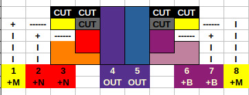

And if you want to use a S-Type 5 way switch, the Cheap ones Take off the PCB and cut at top and the first ones at the top of the middles on both sides and when looking at this it goes from Top LEFT Going Down and Bottom RIGHT Going Up so 1) B 2) B+M 3)B+N 4) N+M 5) M (and if you want it the other way around ever switch N and B or flip the switch 180'

Post by Deleted on Nov 20, 2021 16:50:56 GMT -5
1) Bridge + Tone A 2) Bridge + Middle 3) Bridge + Middle + Neck 4) Neck + Middle 5) Neck + Tone B
IN long terms 5th position: Neck--- Neck tone is used 4th position: Neck and middle in parallel (Neck is not split) --- None of the pickups are connected to a tone pot. 3rd position: All 3 pickups in parallel (Neck and bridge are not split) --- None of the pickups are connected to a tone pot. 2nd position: Middle and bridge in parallel (Bridge is not split) --- None of the pickups are connected to a tone pot. 1st position: Bridge--- Bridge tone is used.

Post by cem on Nov 21, 2021 10:30:43 GMT -5
1) Bridge + Tone A 2) Bridge + Middle 3) Bridge + Middle + Neck 4) Neck + Middle 5) Neck + Tone B IN long terms 5th position: Neck--- Neck tone is used 4th position: Neck and middle in parallel (Neck is not split) --- None of the pickups are connected to a tone pot. 3rd position: All 3 pickups in parallel (Neck and bridge are not split) --- None of the pickups are connected to a tone pot. 2nd position: Middle and bridge in parallel (Bridge is not split) --- None of the pickups are connected to a tone pot. 1st position: Bridge--- Bridge tone is used. Did i use the word proofread wrong? I just wanted someone else to check newey's diagram to see if there are any errors.

Post by Deleted on Nov 21, 2021 10:52:32 GMT -5
1) Bridge + Tone A 2) Bridge + Middle 3) Bridge + Middle + Neck 4) Neck + Middle 5) Neck + Tone B IN long terms 5th position: Neck--- Neck tone is used 4th position: Neck and middle in parallel (Neck is not split) --- None of the pickups are connected to a tone pot. 3rd position: All 3 pickups in parallel (Neck and bridge are not split) --- None of the pickups are connected to a tone pot. 2nd position: Middle and bridge in parallel (Bridge is not split) --- None of the pickups are connected to a tone pot. 1st position: Bridge--- Bridge tone is used. Did i use the word proofread wrong? I just wanted someone else to check newey's diagram to see if there are any errors. your term was CLEAR and to the POINT i just wrote how i read the Diagram and then matched it what you requested as Proof Reading Maybe it a MATHS thing
