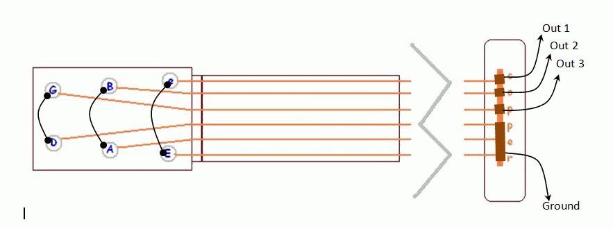

Post by JohnH on Jun 18, 2010 18:51:13 GMT -5
Here's a way to hook up an acoustic, based on D2o's image. Best if the three outputs go to seperate mixer inputs. But for a test, they could all go to one, or to whatever amp is to be used. I think the problem with taking all inputs to one, is a general decrease in output from each string (but better than the 1x6 version I tested), but also the reduction of signal that you would get if you fret a lower string (4 to 6), and a higher string (1 to 3), at the same high fret. This creates a lower resistance path, that partly shunts the other strings. John EDIT: I just had a look at this arrangement theoreically, by analysing a resistor network on 5Spice. I think there are still scenarios where fretting more than one string at a fret will change output of other strings. I think the only really correct way to do this with no losses or quirks is to ground all tuners (or ground a brass nut), then have 6 separate outputs from six non connected saddles. It means that any frets that are used are all at ground potential and cant change the signal. To get the ground connection up to the nut, maybe use the truss rod? Within the guitar, a preamp with 6 input transistors and a summing mixer made from an opamp should do the job
Post by D2o on Jun 19, 2010 10:16:30 GMT -5
Thanks, John
I've tried it - without success, unfortunately.
This could be due to a number of factors:
1) the magnet: I have tried using a single coil pickup in the soundhole, and I have tried using just the bar magnet from the pickup - placing it under the strings just behind the nut (on the headstock side).
Are either of those ideas any good?
2) a lack of any sort of preamp
3) combining the three "+" leads into one "+" that goes to the tip of the cord
Sorry - I don't think I have the right equipment to make this work ...
... any ideas? Or is this best left to someone with a proper pre-amp?
Cheers, D2o
