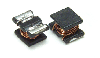

Ok...got a little time to do a bit of tinkering with this... John Asked earlier... soundclick.com/share.cfm?id=11178958well, some program conflicts since I played with this computer recording unfortunately...but was able to record the above 'wavering' on plucked open strings. Lest one think that the tape heads were a complete failure, they do in fact 'make a sound' and not that bad except for the wavering and fairly noiseless too. The last bit used two in parallel on the same magnet (ie polarity) but wiring reversed. It may have been a little quieter in terms of noise (though this unedited clip shows that besides handling noise, there is very little) but no difference in volume from wiring another to it...so that's a good thing to know. I found another/better pre-amp to test things with... shop.aaaa-electronic.de/epages/15164820.sf/en_GB/?ObjectPath=/Shops/15164820/Products/M040it has a gain of x100 though I am running it off a 9volt battery, so that may well be reduced quite a bit though the battery is new-ish. So we all know what I am working with...here is a pic of this rig... I held the Tape head with magnet over the strings 10-15mm from the bridge. This means the string has a very small arch of vibration and an overly bright sound and quick attack. I was using my strat unplugged. There is some evidence of varying pickup distance though I aimed for about 1mm...so almost touching...it will work at more of a distance but volume is further reduced, but they do need to be close (Roland's GK pickups need to be adjusted to 1mm too). They produce a louder volume and better tone of course when tested near the middle of the string. ... So, it is not that the tape heads 'don't work' as has dogged me in the past (on previous old project and at a time when audio posting was not an optionto explain exactly what is going on and what level of success. For some, even with the 'wavering' it may be fine to ascertain a pitch and amplitude trigger signal for midi in fact...but that was not really the aim for this project at this time (though I know others may well be interested in this potential. It could well be a sufficient sound for what I am aiming for, after all there will always be the guitars signal over this...but I am not really satisfied with a sound that has a permanent tremolo effect on it. I am pretty sure it is in the way these mono heads work, reading perhaps only in one direction. A stereo head might fix that as I understand they have two coils (though they might be hard to find/expensive) and the magnets might be tricky to arrange. At times it seems to waver less, the way I am testing it is a bit slap dash, the things are very sensitive so any shake in the hands trying to keep the thing at 1mm and not 1.5mm can and is heard...some of the wavering is accounted for it that, if I brace everything, it is reduced to almost acceptable levels. Moving the heads a little further from the string reduces volume but also significantly helps with the wavering effect...possibly usable with some further experimentation and a bit more pre-amplification. Alighning them a little to one side of centre might possibly help with the wavering, it's a little hard to tell without the ability to 'hard mount' them to take away human interference in the performance at this stage. I had wondered if the close proximity of the bridge pups magnets might be affecting things. I flipped the driver magnet but detected little if any difference, but not the best test. I might be able to explore things more with the project guitar or an acoustic to take that element out of the equation perhaps...but I don't think that is the case. playing with the pickups over the fretboard makes it worse, so I imagine it is the arch of vibration as much as anything...along with the coil arrangement and devices characteristics. Compared to the HB output of the strat, these things at best scenario are about 3/4 the volume of the guitar (amp setting the same). The sound clip was recorded direct into the computer with no noise reduction or effects of any kind btw... If one plays them over the 12th fret where there is a lot of string movement, the devices are much louder than the host guitar. Also, although using shielded cable, there is some handling noise of the heads and the leads I wonder if some kind of transformer would help boost the output better before it reaches the preamp? To get a decent sound in the amp (not the recording) I need to turn the treble all the way off and this should perhaps be built into the preamp system as a matter of course to get a more normal guitar sound to process (though a processor could do that itself of course. Might need some help to work out how to mod the preamp for best performance there! The noise (I'm testing things as they come to mind as I type, sorry about the disjointedness) is slightly improved by grounding the head cases (which are also serving as the magnet which is attached under them). AHHH...Just thought then, I have a pair wired rw so if I stick them together and add another mag to make a tiny HB, it is louder, better tone (wider sampling of the string) and less if any wavering...hmm...interesting...shame I don't have a 12 the same size, or even six just at the moment...might have to ger still more of the things, bugger! Not sure that that is the answer though...but it is an option I guess and an avenue to explore. ... An interesting thing I found is that you can now get a 'variax' in a rack... www.rackvax.com/ At 1,200 it is not cheap...plus you need a hex system guitar...hmmm My intention is similar to the variax in some ways, but using common digital or analog effects on the output of these things. ... For comparison and not to get too tied to the one idea (ie tape heads) I just thought to try an alternative I have up my sleeve here. This is an inductor (or choke) on a ferrite core and a resistance of about 1 ohm I think. I stuck quiet a strong rate earth mag on the back of it...but there might be a better solution. Regardless of the strength of the magnet, little is getting through the top...interesting, might be the bobbin shape affecting things adversely compared to a normal pickup non magnetic bobbin top. This does not 'waver' (so it isn't just hand shake LOL) and a similar output to the tape heads perhaps. These things could be worth exploring more (though don't look anything as cool as a tape head and just happens to be something I had lying about). It definitely needs the magnet or there is quiet a bit of noise out of it...all these are effectively single coil pups after all...and right next to my computer and a valve amp three feet away...so noise is relative, a lot of normal strats are far worse under such conditions. Certainly if the aim is purely to get a signal from the string...these will work...so that's something right there in 5 minutes...while typing...now smaller ones in pairs perhaps would make them HB...hmmm, thinking all the time!
Post by 4real on Nov 1, 2011 5:23:48 GMT -5
Been doing a bit more tinkering on this exercise...despite the horse racing carnival that 'stops a nation' and stormy weather...
So...the tape heads were not quite as good as I had hoped (though I had already ordered enough to make a matching set...in fact two...
However, from long ago in sustainer land, I have kept quite a few esoteric parts from such experiments many of which will work in reverse for such a thing as a miniature hex pup...
So devised about 6 and most of them have worked so far and I have a few other things I'd like to try too.
These things are very low impedance, so will require a bit of pre-amplification, they are also sensing the string right at the bridge so no pickup is going to put out a full power where the string movement is so little (hence bridge pups are generally stronger to compensate).
Some of them have been getting silly small...one is only 2x4x1mm plus a magnet LOL...perhaps just a little small, but did work and possibly hum cancelling too.
The one I was most taken with is effectively 6xHBs and 10x10x the string spread (say 60mm) and operated quite well 10mm from the bridge, better even further where there is still more string movement. Good separation and could potentially be made even smaller with other kinds of parts and magnets (which take up more room than the sensors, but could be smaller with rare earths). The things being HB are very quiet and I now realize that noise cancelling is vital if a lot of pre-amplification is going to be required...any noise could be amplifed 100+ fold, so don't want that!
I'm casting around for ideas as to how others might use such a device and whether to develop things further with cost and time...or to just make the one prototype out of what I have and be done with it.
Also, anyone with circuit skills who might suggest how one might go about preamp design and filtering of a bit of the highs off it...being so close to the bridge and very clean low impedance devices (less than 2 ohms per pup)...
I am wondering if it would be beneficial to run the hex pup through a transformer to 'step up' the impedance. I believe that is how lace do it with their 'single turn' alumitones ... hmmm ...or is there no advantage their when active electronics are involved anyway?
Meanwhile, bidding on an old Roland GK and synth...so there is the possibility that I might get it and use something like that anyway.
But there is something cool for my purposes in the DIY version and perhaps others might be interested in such ideas, so may as well keep exploring the possibilities.
If one were considering such a pup, what application would others be using it for, what kind of size or other specs would one desire, what kind of outputs would such a thing be realistically used for...that kind of thing.
On my project, being an arch top, I have a bit of space to play with from the top to strings (over 20mm) and as these things are getting smaller, am now considering having the hex pup mounted to a novel outrigger on the bridge itself (screwed in so removable)...I'd apply the same method for a roland.
If I were to go with a 'synth' I might hack the controller to make something internal out of it and use ideas like the thumbwheel pots and miniature momentary switches in the F holes for control...though there is every possibility that I ight save it as something that I could apply to other guitars...have to see if it can in fact do what I might hope musically, or if the original digital processing plan is more appropriate.
I've not yet worked out how to connect the guitar with three pickup systems to the outside world effectively and reliably. I do have a 4 core quality mic cable about, but what kind of connection is still up in the air for it...
Post by 4real on Nov 7, 2011 4:10:12 GMT -5
Still awaiting parts for this concept that is quickly evolving from 'hacked' tape heads to a really unique new and very small pickup design. The more I think of the design, the more applications I can see for the things/thing.
On my current project, the hex or 'divided pup' will be an optional extra output that will allow separate processing of selected strings by miniature switches built into the pickup assembly itself.
I think that these things could be used to great and simple effect as a sole or auxiliary pup on something like an acoustic guitar, mounted near the bridge or by the soundhole. They are light and compact and low impedance and could be run in stereo with a similar switch system to send selected strings to different outputs for instance.
Similar applications could be made in an electric guitar and perhaps even built into an HB enclosure with a rail pup or similar next to them to provide a divided output in various forms.
So, the design work in the background on these things is working out how to enclose these things while i wait for parts. The enclosure, like with the sustainers of a similar type, are an integral part of the design. Likely set in epoxy into a solid block.
I am still thinking to build each string driver separately with two wire leads each to be arranged perhaps on perf board as required. The first real prototype for this guitar though is likely to be a complete unit.
Internal wiring needs to be miniaturised and while not applicable to this installation, a 6 core shield cable significantly small (such as Roland use on their GK's may be required. As the initial application is mono, I can get some pretty small stuff for that...internal wiring will be done I suspect with enamelled wires, unless I use a strip-board or similar.
So, no progress other than planing stuff while waiting for parts at the moment. I have abandoned going down the whole roland GK/synth route. Demand fro second hand units seems fairly high and the systems look like not being able to do exactly what I want it to do, cost a lot and have quite a few down sides like latency and a lot of equipment to drag around.
The system as I originally conceived has little of that, no latency and uses normal digital process for the effects and basic pre-amping and wiring for the outputs. Each application would have different requirements, but mine at first will be mono and so I suspect a simple preamp will be all that is required in this case.
