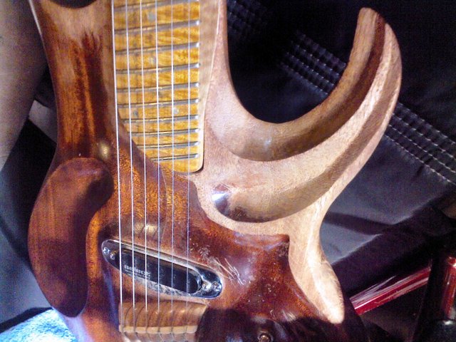

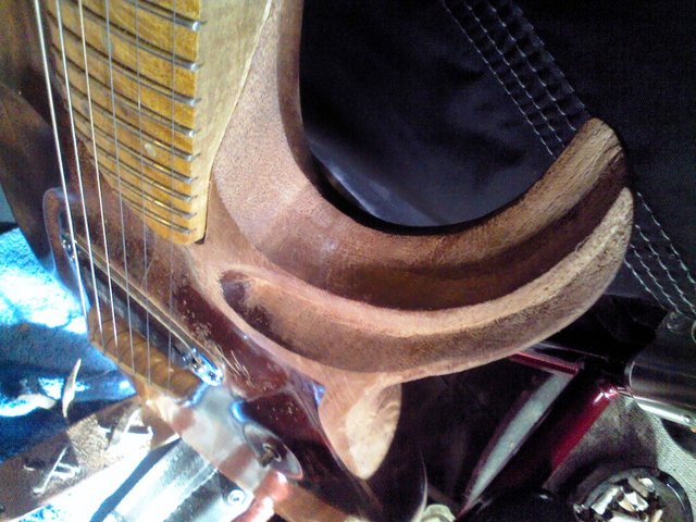

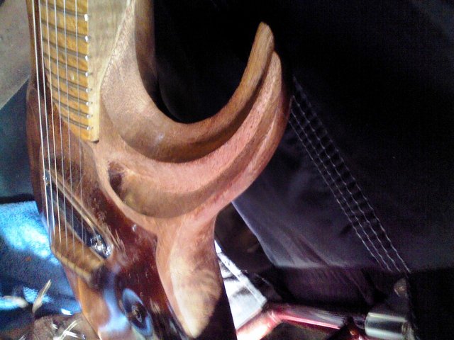

Post by gitpiddler on Feb 8, 2021 8:49:53 GMT -5
Hey y'all, I've picked up and moved to my fren Indy and 'ems place. He's now left-side paralyzed from strokes, and hadn't finished this 11yo beast. His 12-string beast has been featured above. This is his first electric project. She has a 2pc. flame maple neck with 27 fanned frets. 2pc. carved mahogany body with bone nut and saddle and EMG Select bridge PU. So far I've shaved the back and treble horn, dressed the fret ends and headstock wood.
