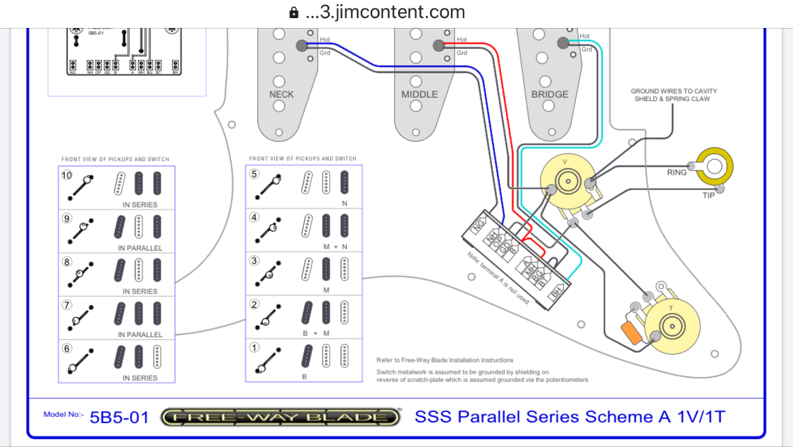

Newey, I’ve moved over to the Module section to post the schematic for the Freeway. It’s from a pdf file so I hope you can read it. Made one slight change to it to have the 3 pickups in series; but, this is the official schematic. I changed the tone controls though. The actual tone controls are not dual gang nor center detented. You might think that finding the midpoint is weird but it isn’t. A guitarist is usually on one side .015 or the other, .022. I can’t find the new 5 way on their site. The 10 way works like an exotic gear shift, one has 5 selections, then one pushes the lever over to the right and one has 5 more positions. Its the first one I used and I like it (although it’s 40 bucks! Or 33 pounds.) Ouch!! Im getting ready to test it out. I’m not completely sold on whether it will be worth it tonally. Next, I have a 2 wafer EYB mega mega switch Dieter at EYB made for me. I’m going to try that in the next build. Thanks Newey😊 Oh, and this Freeway build was for a client.
