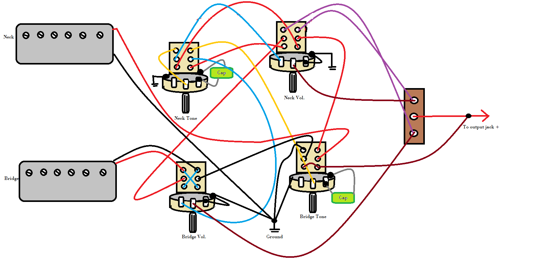

OK, cem, here's what I come up with. Please note that my confidence level that this is right is not very high. And, given the level of complexity here, it may be awhile before someone else volunteers to spend their time tracing it all out. So don't start wiring it just yet . . . A few notes about the diagram. First, I have only shown grounding of the pickup negative wires and I show the V and T pots being grounded to the backs of the pots. For the sake of clarity, I have omittted all the other grounds, as well as the output jack. If you use the backs of the pot shells for grounding, you will need to collect all of those grounds together with the jack ground. I also omitted the string/bridge ground, as well as any grounding of the switch casings. Second, wires which cross each other are not connected, unless there is a black dot showing that connection. Obviously, you don't make a solder connection in the middle of a wire; the connection goes to the next lug down the line.

newey the wiring is finally done. I don't know what went wrong but the wiring behaves quite differently now. Neck Volume pot acts like a kill switch on all positions, unless neck tone and/or bridge tone is on which turns the sound back on but there is no difference in tone. Neck tone pot by itself does nothing. Bridge tone pot overrides the 3 way switch and activates Neck pickup on all positions. Bridge volume pot works as intended as a phase switch. But thankfully, if you dont turn any of the switches on on the guitar, it behaves just like it should lol So can anyone help? If someone could proofread this it would be awesome. Or did my eyes miss something?
Post by newey on Jan 21, 2021 12:14:43 GMT -5
Sorry that you're having trouble, cem. I was hoping we'd get someone else to vet my diagram beforehand, but unfortunately no one did so.

Post by cem on Jan 29, 2021 18:04:51 GMT -5
Post by newey on Jan 29, 2021 20:42:09 GMT -5
Bridge tone pot overrides the 3 way switch and activates Neck pickup on all positions. The bridge tone pot is supposed to override the 3-way switch, but it's also supposed to give both pickups in series. It looks like there is an error in my diagram at that switch. I'll need to go through this thoroughly again, hopefully that's the only error I spot.

Post by newey on Feb 6, 2021 8:34:31 GMT -5
Sorry, cem, to have neglected you on this. I really need someone to double check this diagram for me.
I do spot one error (there may be more). The brown wire that runs from the bridge tone pot to the output jack is wrong. If you remove that wire, the series parallel switch on the bridge tone pot should work (again, as I see it), but will only work when the 3-way switch is set to the Bridge pickup position. The goal was to have the series/parallel switch work regardless of the position of the 3-way switch, but I can't figure out how to make that happen without having to add more switching.
You've been more than patient with me, cem. Let me see if I can get someone to help us with this.
Post by Yogi B on Feb 6, 2021 17:06:05 GMT -5
Let me see if I can get someone to help us with this. On multiple occasions I've opened this thread in a new tab after it's been bumped, but until now have never gotten around to looking closely at it. I'm not worrying about your diagram yet, as I think there's a more fundamental problem: Neck Volume Push-Pull: Solo switch (Bypasses everything and activates the bridge no matter which pickup is selected except for the toggle switch so that i can choose between pickups or use both.) Everything else seems reasonable enough, but I don't think this particular option is possible with a regular push-pull. In order to properly bypass a single set of volume & tone controls requires two switch poles, so you'd need a 4PDT to bypass all four neck & bridge controls (and an even larger switch if you also want to bypass the series switching). As I see it there's three options: - Keep it as per your original wiring, a bridge solo switch, this would be the only option to truly bypass everything including the series override switch;
- Make it a max volume switch, both volumes wouldn't be completely removed from the circuit, but would act as though they were set at maximum -- neither the tone controls nor the series switch would be bypassed;
- Partially bypass the volumes & tones of both pickups, this will remove the parallel loading of both the volume & tone pots, but will instead add some series resistance (between zero and 1/4 of the volume pot's value, depending on their position) -- this series resistance will cause the capacitance of your cable to cut highs (though, treble bleed's would eliminate most of this) additionally this won't play nice with certain low input impedance pedals (e.g. Fuzz Faces), finally once again the series switch will not be bypassed.

Hey Yogi B Well in that case i would go with the first option. The way it was before as a bridge solo switch was actually quite useful.
Post by Yogi B on Feb 11, 2021 19:09:55 GMT -5
This is what I've got, I don't know that I'm super happy with it, but it should give you what you're after. The bridge solo switch is wired after phase switch (doesn't bypass it), but that doesn't really matter since only the bridge pickup will be selected. Also the multiple conductor / shielded wire is merely a suggestion -- so long as everything shown to be connected is done so, it should be fine -- it just kept things a little more organised.

Post by cem on Feb 12, 2021 7:28:56 GMT -5
Yogi B you are a life saver. I came back to bump this thread again, then i saw your diagram. You've made my month By the way, I also want to try a different treble bleed on this guitar. I like it as it is right now but the taper is bugging me(150k with 1nf cap in parallel). According to this article from seymour duncan, wiring them in series would solve that problem. 3 Popular Treble Bleed Mods: What You Need to Know
