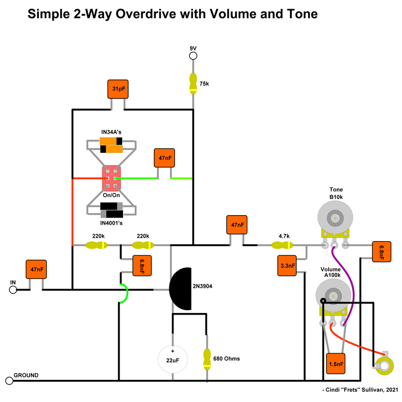

Last night I build an overdrive pedal for a good friend’s son’s birthday tomorrow. I wanted to put something together quick and better than my last circuit “Cindi’s Nightmare.” I found another Electra variation by Joe Davison and I further modded it by changing resistor and cap values, adding an on/on diode selector, a volume and a tone. For what it is, it turned out really well. I’m posting it for others that, like me, are learning how to build pedals. I forgot in the diagram to put the stomp switch in. 🙀

oooh diodes in the feedback loop like a big muff and what looks like a notch filter
