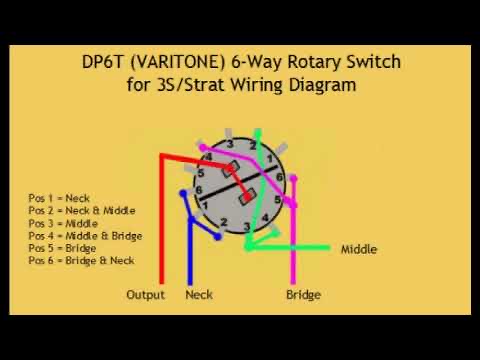

Post by frets on Apr 20, 2021 14:45:18 GMT -5
Nichstp, Here’s the diagram.

Post by xlunacy on Apr 20, 2021 16:29:59 GMT -5
Swapping the 3 and 4 lugs from each side creates a neat and symmetrical wiring would that work just the same ?
