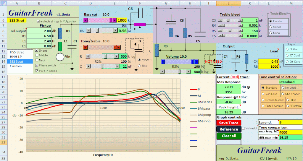

Tnx JohnH, your GuitarFreak is wonderfull. So I'll try basic version on android
Post by JohnH on Jul 4, 2015 20:37:36 GMT -5
I have uploaded a new version of GuiatarFreak - see the 1st page of this thread for details of version 5.01:
There are quite a few new features, including:
Multiple graph traces with legends Wider component range including some in-between pots values Log or linear pots More tone control options Relative volumes of different pickups
cheers John

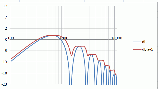

Tillman - Pickup response
After some basic theory, he gets to plots such as this, which is the key to everything that follows:
Thinking about this, it represents the tonal signature of a particular string with a particular open length and open frequency, and a particular pickup sensing point. The nulls are where multiples of the half wavelength of the resulting note match the distance from bridge to pickup. What is interesting is that one such plot covers not only the fundamental and harmonics of the open string, but also of all the fretted notes too.
You can see the roll off at low frequencies. This is due to the pickup being located at less than halfway so it only sees part of the maximum string motion of the fundamental note. A pickup at mid-length would have no such low roll-off. Apart from that, the peaks are all at the same level. Tillman explains how this is appropriate since the reduced displacement amplitude at higher frequencies is compensated by the greater sensitivity of the pickup to higher frequencies.
He then goes on to consider the width of the pickups, in terms of an effective width over which the signal is averaged. This has the effect of attenuating higher frequencies and he concludes that it is similar to a 6db per octave roll off, starting at a frequency of 0.866L.F/W where L is scale length, F is open frequency and W is sensing width of pickup, which he states is about 1” for a single coil and 2.5” for a humbucker. Here is his humbucker roll-off plot:
Putting this into GuitarFreak
So I had a go at reproducing the above in excel, in which string output as a voltage is dependent on:
sin (distance from bridge x frequency/scale length x open frequency x Pi)
Then I took a group of points each a short distance apart and averaged the results, which confirmed Tillmans roll-of equation above. 20 x log of all that gives me a db response.

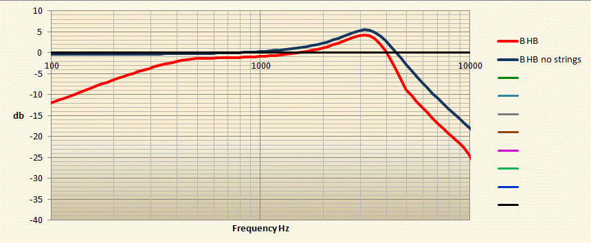

But the trouble with plots like these as with real signal traces from guitars is that they are all up and down with many peaks and nulls. For GF, inputing this would make it very hard to be able to appreciate the changes due to circuit adjustments etc, which is the basis of it. What is needed is more of an overall envelope picking up maxima, derived from the individual plots.
So what I have is an envelope derived from the maximum responses of a number of strings (user can choose up to 7). This is based on the maximum signal from any one string at a given frequency. Plus, it take a moving maximum being the highest within a range of -2 to +3 semitones. This is enough to join up all the peaks resulting in a fairly smooth curve. I included Tillmans formular for taking account of pickup sensing width.
This envelope is then taken into the main part of GF to be combined with the electrical frequency response. Here is a bridge pickup, both including the string/pickup response, or just the electrical response:
Then the fun starts when pickup combinations are included. This can be done in parallel (average output of active pickups), or series (sum of signals). The parallel combinations from each pickup are based on their relative impedances. So far, I'm just using inductance for this, since it is the dominant characteristic across most of the interesting frequencies. Phase switching is included too, and with humbuckers, local series, split and parallel wiring is included, and slant can be added to the bridge pickup
Then the final output in terms of db's v frequency, is combined with the electrical results of GF to give a final plot. Here is a Strat B and M pickup combined in various ways in and out of phase:
So hopefully, despite many assumptions built into all of this, the results are now at least somewhat more representative of reality, to the extent that that is possible on a single visual plot representing a complex combination of sound. Some of the biggest assumptions are to do with the pickup characteristics themselves. Just to model them to the extent possible so far with this system, 6 parameters are needed:
1. Distance from bridge - at least that can be measured 2. Sensing width - Tillman suggest 1" and 2.5" but does not justify these. Other references suggest less. 3. Resistance - easiest to measure and the least important 4. Capacitance - hardly ever quoted but Helmuth Lemme gives some values, which can be extrapolated to others, and its not too critical 5. Inductance - very important, but only a few manufacturers quote it. 6. Output level - relative to other pickups. There is no standard for this, and only DiMarzio give values in mv , but at least that is a start and other makes can be guessed relative to DiMarzio models. We can also say the series wiring of two similar pickups adds a basic 6db, and split is -6dbetc
There is no one supplier who provides all the data - hence some of the assumed readings may be questioned and should not be taken as definitive.
Hopefully useful though, and may prove to be reasonably valid with a bit of testing.

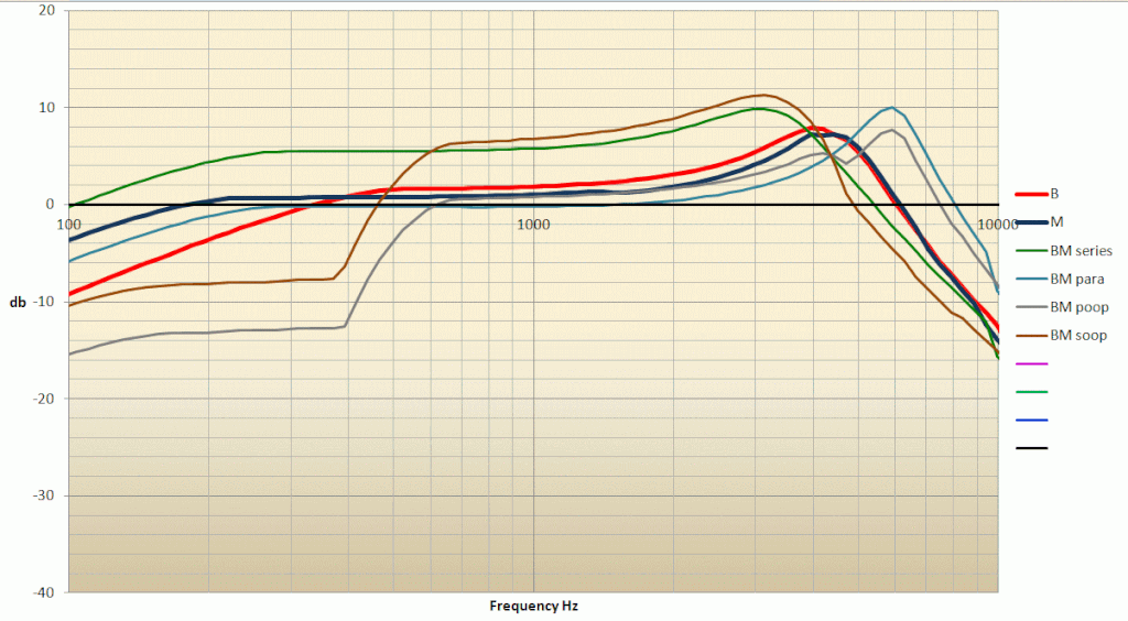

Post by gckelloch on Aug 19, 2015 23:51:40 GMT -5
It's helpful to see those averaged spectra. Thanks for doing that. Not surprising the bridge position really rolls off the bass. Another factor not considered is the impedance response of individual pickups. Different core materials create various eddy-currents which affect impedance. Many pickups also have various losses from stretched or cracked wire insulation. GF really just shows the spectrum of ideal coils, but I find it helpful to design wiring schemes none the less.
Post by JohnH on Aug 20, 2015 2:43:50 GMT -5
It's helpful to see those averaged spectra. Thanks for doing that. Not surprising the bridge position really rolls off the bass. Another factor not considered is the impedance response of individual pickups. Different core materials create various eddy-currents which affect impedance. Many pickups also have various losses from stretched or cracked wire insulation. GF really just shows the spectrum of ideal coils, but I find it helpful to design wiring schemes none the less. Thanks for your comments. References that Ive been reading recently suggest that these eddy losses could be approximated by adding another resistor to the pickup model. If considered in parallel, some measured estimates were around 1.5M. Im sure the truth is far more complex! But if you take that as an assumption, it will make a small reduction in the peak height. Current GF has a load resistor tone option that could test it. I might build this in more comprehensively. But at the moment Ive been trying to capture more string vibration characterisics in the form of overall envelopes. The plots above include aspects of pickup position and width, but assume that all string harmonics are capable of equal output (equal string velocity). But there are equations for the harmonic bakance if a plucked string which show a greater roll-off than this. Ive been combining max envelopes of all harmonics and all strings, varrying where they are plucked, with equal force. Im finding a good match using a function with a level response up to 1 to several x the highest fundamental, then a -6db per octave roll off. That will be added to all the other effects. So the idea is that the GF system will allow string harmonics, pickups and I might add amp and speaker, to be engaged tweaked and dissenaged, along with tbe electrical parameters. Im hoping that this will result in plots that are more similar to real recorded signals, with the ability to test the influence of each idealised parameter. .
Post by gckelloch on Aug 20, 2015 23:13:39 GMT -5
Different pickups have impedance humps in different ranges, so it's not just a matter of rolling off the highs. Some passive pickups even have midrange dips. Check out the “UIUC Physics 193/406 Acoustical Physics of Music/Musical Instruments Measurement of EM Properties of Electric Guitar Pickups” that shows the impedance response of a bunch of common pickups. You'd at least have to know the impedance response of your pickups to get an accurate analysis. What you've done so far is quite useful. Lofty goals you aspire to, but it may be futile to include more elements in the signal chain. It might be nice to have the ability to play modeled guitar sounds filtered by the results. It will never be quite like a real setup considering how individual guitars sound with various strings, picks, and playing technique, but hearing a representation of the analysis would be helpful.
Post by JohnH on Aug 21, 2015 19:59:00 GMT -5
Yes indeed, its a learning exercise and accuracy is difficult to achieve.
But, today I've arrived at a point where I have added some maths what may be able to approximately address one of the biggest differences left in matching calculated results to actual measured spectra, which is to do with the proportion of each harmonic in a vibrating string. This plot shows for a bridge humbucker: the pure electrical analysis, then one that incorporates a bridge pickup position and humbucker sensing width, then as above but putting each harmonic into its expected proportion (based on an envelop of all strings, assuming a certain fret and picking position), and then the same for a neck single coil (see lower two traces):
They seem to show how the usual electrical calcs overestimate the high harmonic content.
But how close to realty is this?

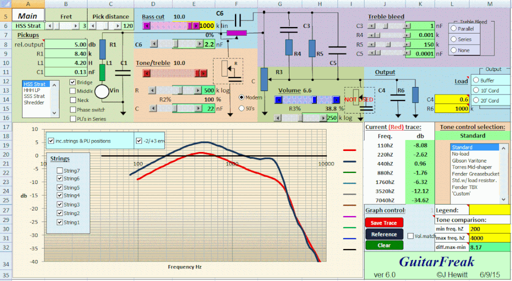

So I got my HSS Strat which has electrical properties that I know quite well, and modelled that, allowing for a measured cable capacitance, into a neutral buffer and mixer. Frets were capo'ed at the 3rd position and a number of strums were recorded, analysed and averaged, picking at 120mm from the bridge. Then, the traces superimposed with the calculated equivalents and levels matched:
The calculations are targeted at picking up an envelope of the overall response. The correspondence is not exact, but I think it is not bad for a first attempt. You can see the low and high roll-off of the bridge hb as compared to the neck single, in both the actual and calculated traces.
These are the first traces that I have been able to make that look anything like real spectra from a guitar, so I'm happy about that.

I have just uploaded a new version GuitarFreak 6.0, which includes the effects of pickup placement, sensing width, string harmonics and picking position in addition to electrical characteristics.
GuitarFreak 6.0 can be downloadd here:
GuitarFreak6.0(excel 2007)
It is described in the first post on this thread, together with the previous version 5 which I will leave in place.
cheers, if anyone tries it, let me know how it goes. It was quite a learning experience for me!

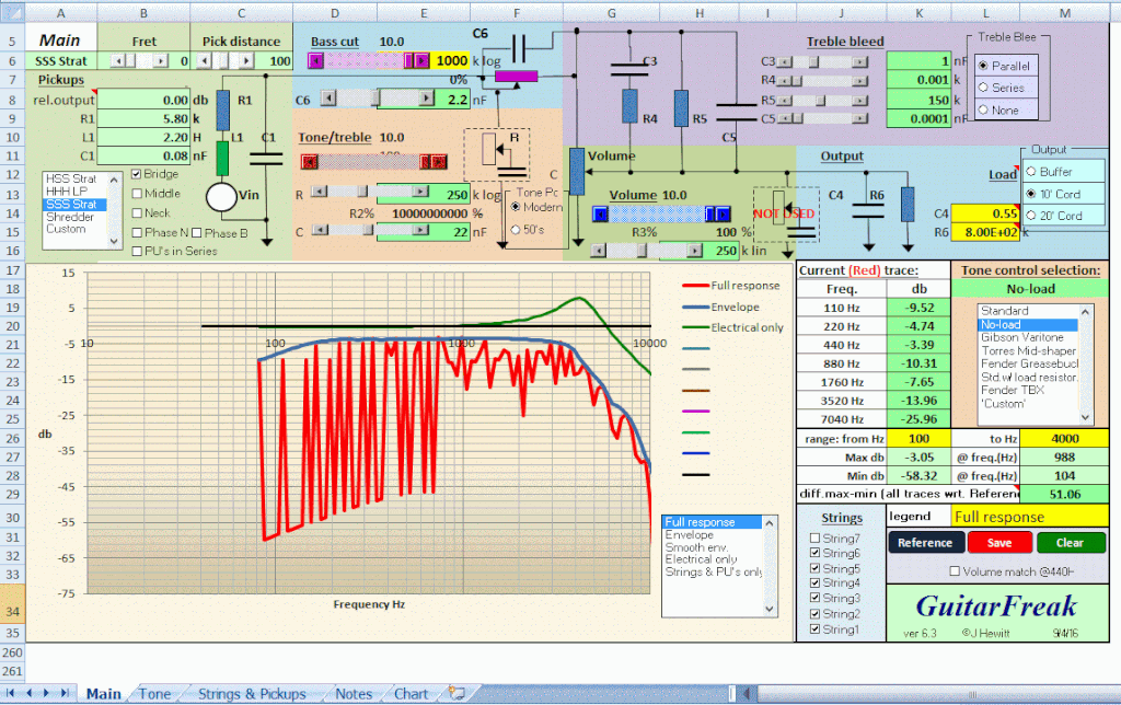

GuitarFreak - Latest version 6.3The latest version of GuitarFreak is version 6.3. It has the same scope as version 6.0, with the addition of a 'Full Response' setting which shows the individual separate harmonics of each active string, as influenced by pickups, fretting and picking position plus electronics. Alternatively, overall envelopes can be shown, or just the pure electrical response. Internally, I have also changed the way strings are combined to create envelopes, giving a more consistent output. This is how it now looks, it can be downloaded at the links below: The previous version 6.0 added representations of pickup placement, string harmonics and picking position to GuitarFreak, to combine with the electrical calculations that were in earlier versions.
Download links for version 6.3:
GuitarFreak6.3(excel 2007) GuitarFreak6.3(excel 97-2003)
See also, the first post on page 1 of this thread (which is overdue for a complete do-over rewrite, hopefully sometime soon).
